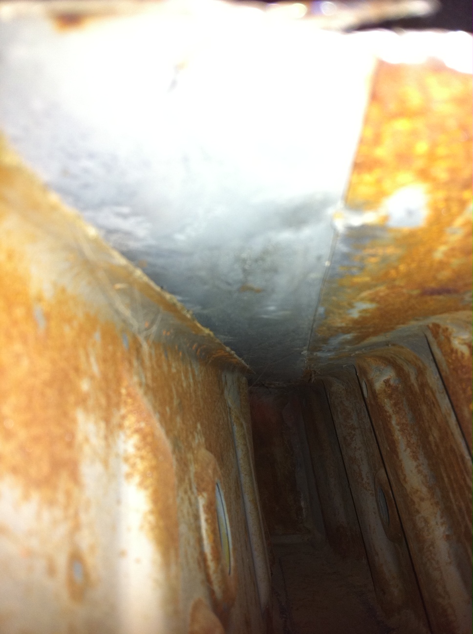

MrHyde   So Its been a while since I posted last.. I have b...   Apr 10 2011, 04:53 PM
MrHyde   inside the frame rail.   Apr 10 2011, 04:54 PM
MrHyde   I have the last week of April off, so I'm gath...   Apr 10 2011, 05:01 PM
