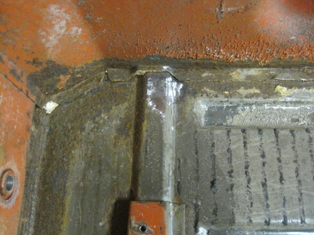

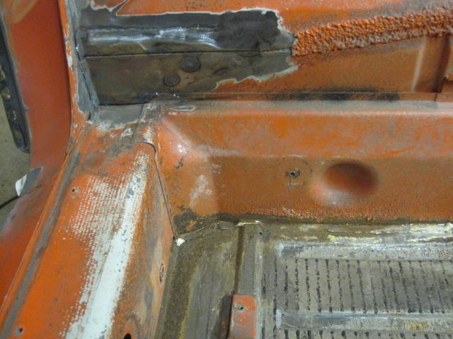

I removed the tar sound insulation on the floor panels per a suggestion I saw from Scotty and I am glad I followed his advice. I did find some rust but fortunately it was fairly minor with only one 1/8 hole that I welded up last night.
