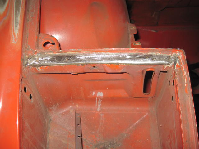

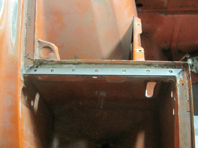

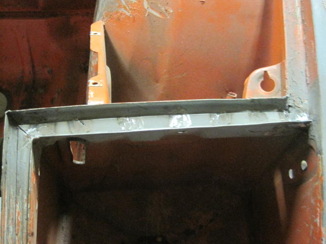

The car is very solid other than a few minor spots. Here are some pictures of the front trunk seal repair around the headlight. I had to grind out the rusty front channel.
Then I made a new piece of channel and fit it.
Then I welded it in and finished it.
