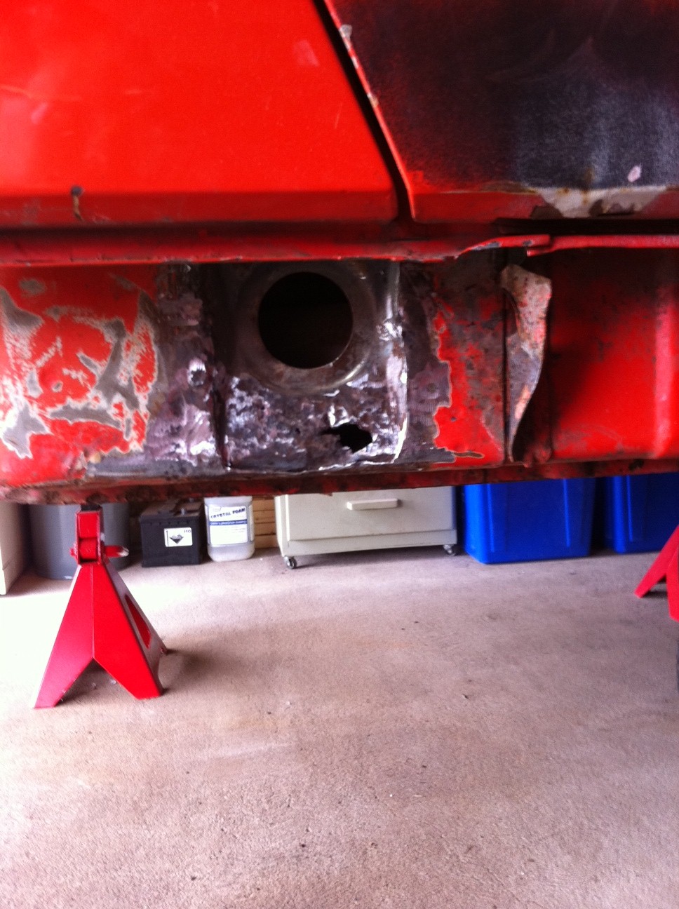

Got the remains of the jack tubes and plates out yesterday, and started drilling out spotwelds on the floorpan today...
We aren't building cars at work much right now due to parts shortages from Japan, so NO overtime !! (IMG:style_emoticons/default/biggrin.gif) a bit more time for working on the 914.
I wont be putting new jack tubes in the car. Seems a bit silly since they rust out so quickly. I'll use a scissor jack if i get a flat. I'll fab up something to keep the strength there.
