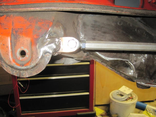

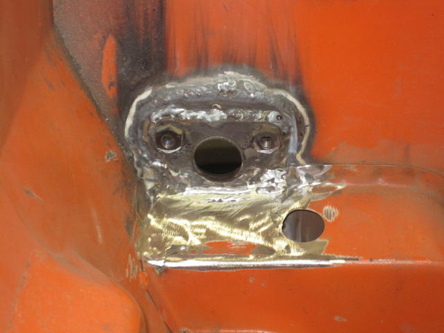

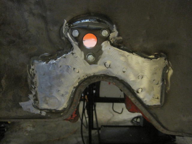

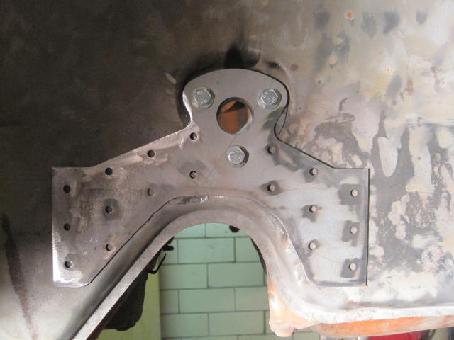

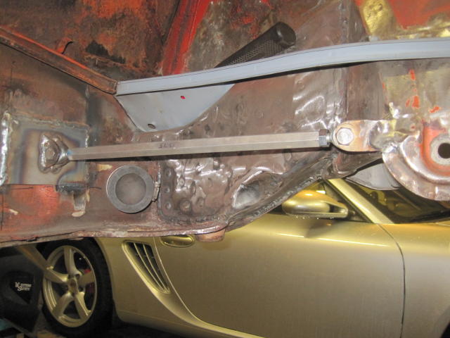

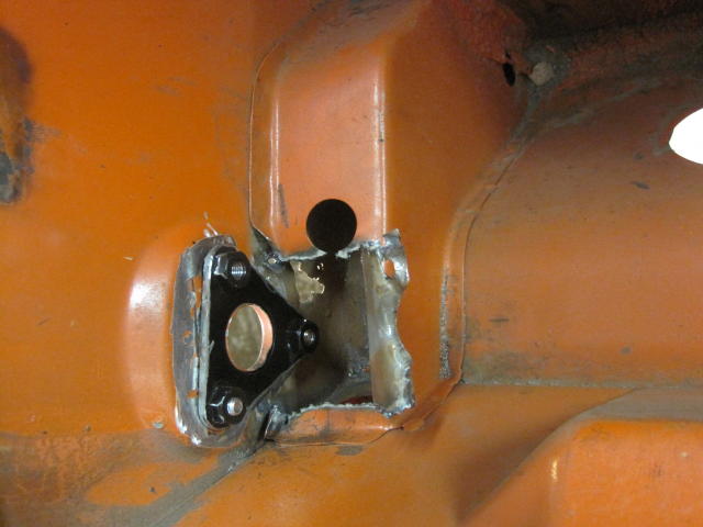

Made some more progress on the front swaybar improvements. Here is the cutting open and fitting part:
Then welded it back together:
Then the fitting of the outside reinforcement pieces:
After welding and some grinding:
Then I worked on the rear of the car and did the dog ear supports.
