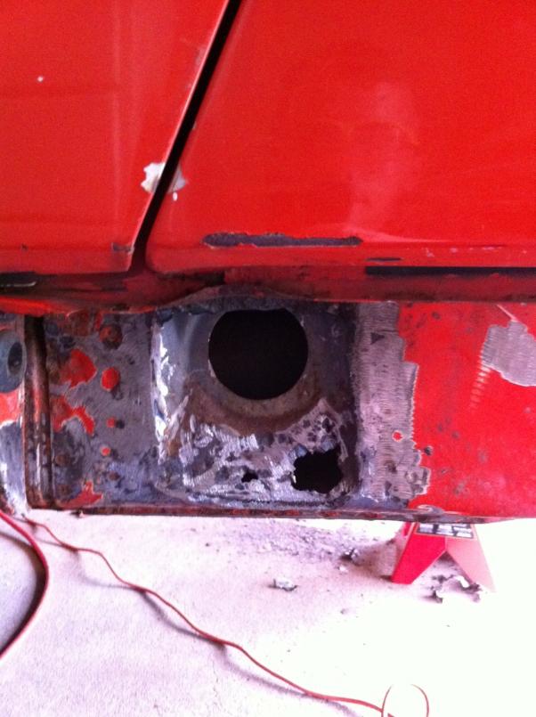

MrHyde   Got the remains of the jack tubes and plates out y...   Apr 26 2011, 09:41 AM
MrHyde   left side   Apr 26 2011, 09:42 AM
Strudelwagon   left side WWII planes? Are you working at the ...   Apr 26 2011, 12:56 PM
MrHyde   I volunteer at the Canadian Warplae Heritage museu...   Apr 26 2011, 02:24 PM
