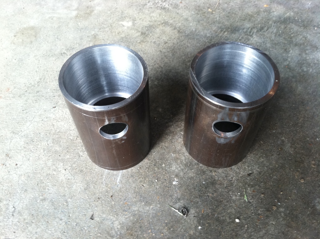

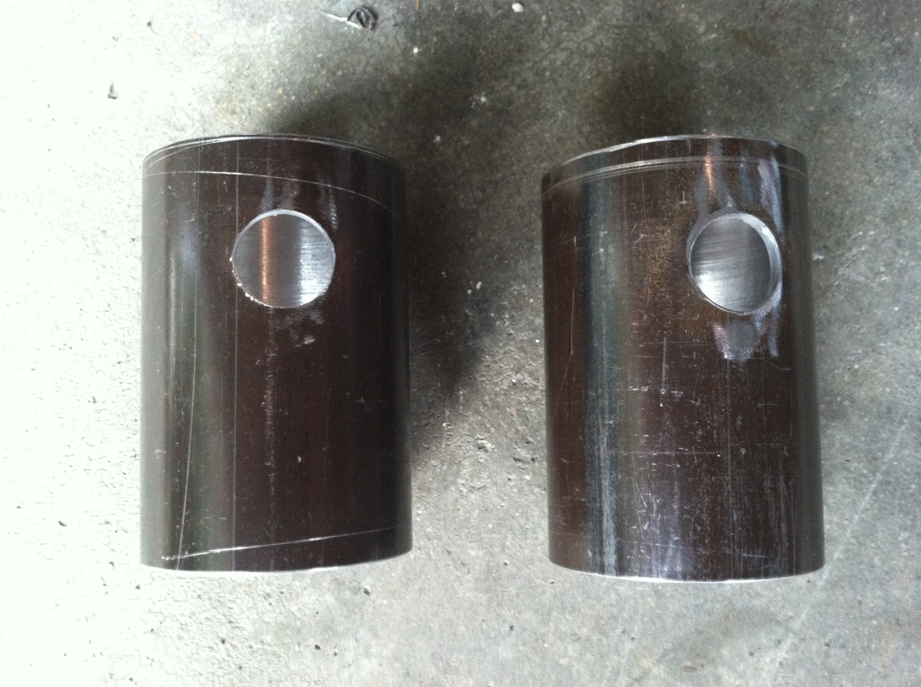

I made the sleeve to fit the bottom of the strut
(IMG:http://www.914world.com/bbs2/uploads_offsite/i163.photobucket.com-12156-1305345424.1.jpg)
(IMG:http://www.914world.com/bbs2/uploads_offsite/i163.photobucket.com-12156-1305345424.2.jpg)

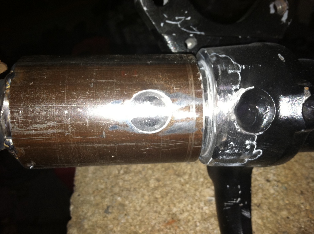

I decided to plung mill a good 5/8" hole to plug weld them against the strut tube much like the way the spindle is attached.
Then I welded the Ball joint mount to the sleeve

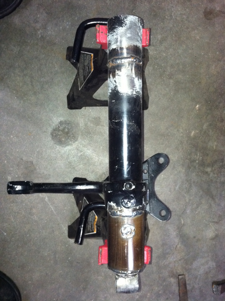

After I welded the mounts on I then slid the sleeve over the strut and tacked it on
(IMG:http://www.914world.com/bbs2/uploads_offsite/i163.photobucket.com-12156-1305345425.4.jpg)

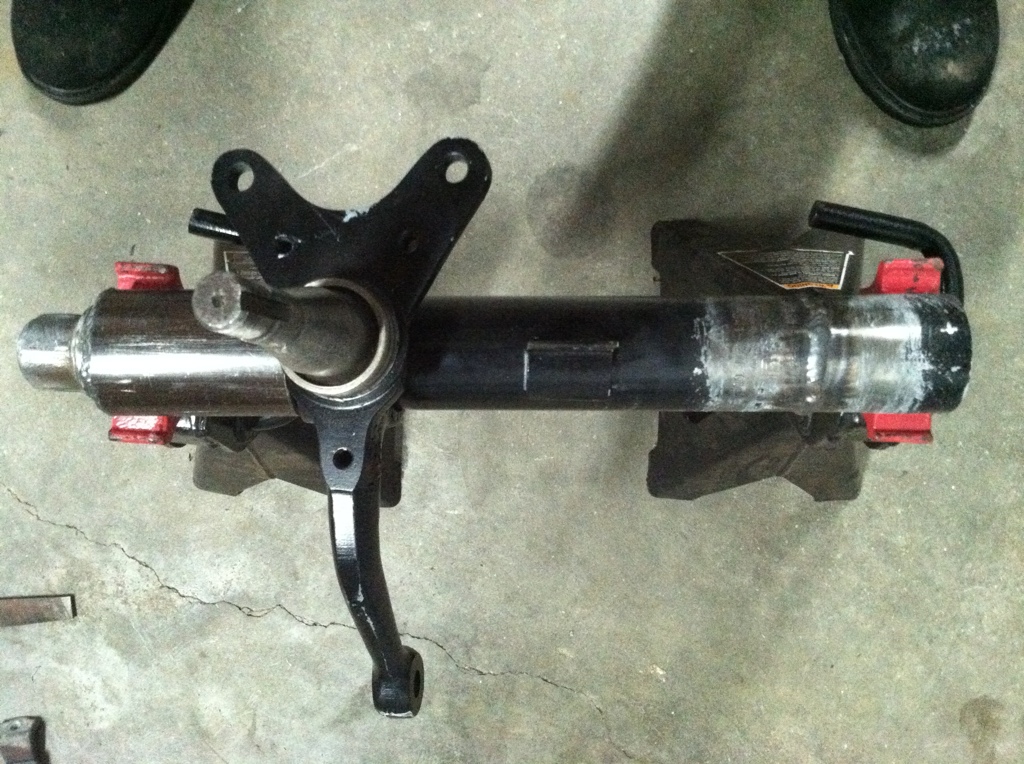

After I measured everything and ensured that it was square I finished the welding.
(IMG:http://www.914world.com/bbs2/uploads_offsite/i163.photobucket.com-12156-1305345425.5.jpg)

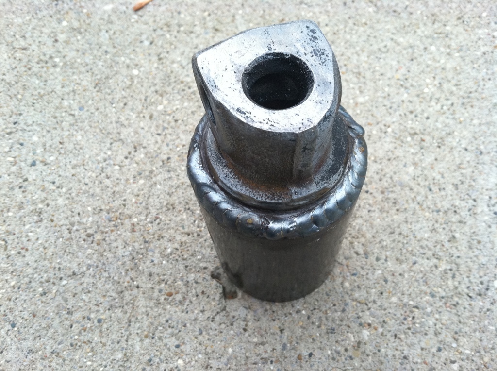

(IMG:http://www.914world.com/bbs2/uploads_offsite/i163.photobucket.com-12156-1305345425.6.jpg)
