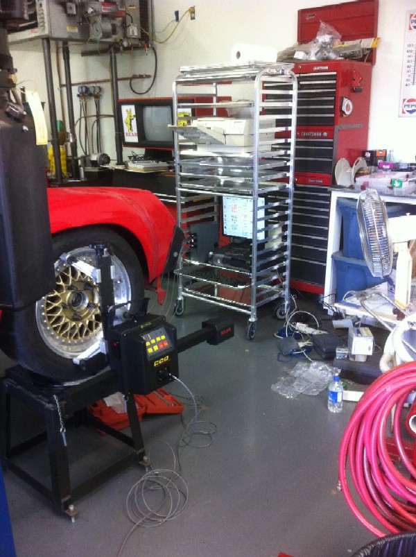

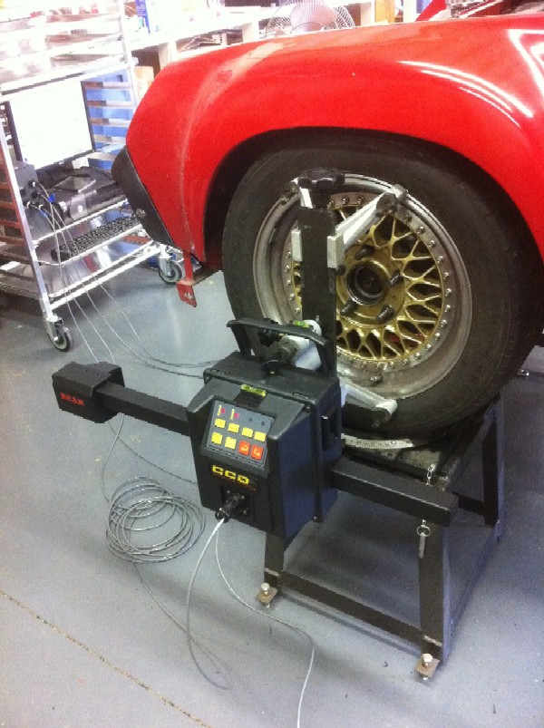

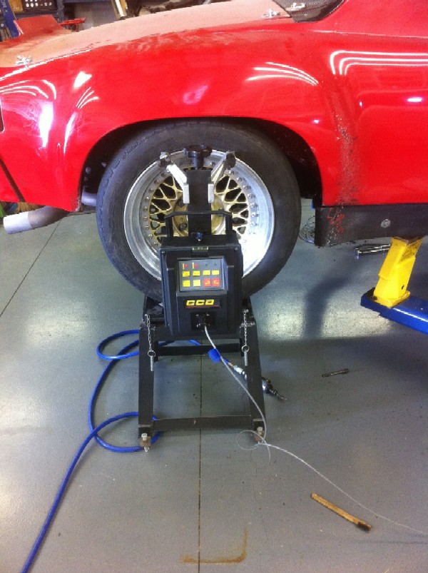

BK911   I use a setup very similar, but with electrical co...   May 14 2011, 09:18 AM
sww914   I've done hundreds of alignments with computer...   May 14 2011, 10:56 AM
