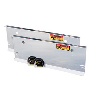

Assuming you have a perfect square, the strings method will give you the same reading as a "toe bar". If your center line is off on the toe, you will still get the same reading with the toe bar. I see a toe bar (or toe plates) as a secondary system. Which I intend to use at the track... Like the Longacre toe plate system.
