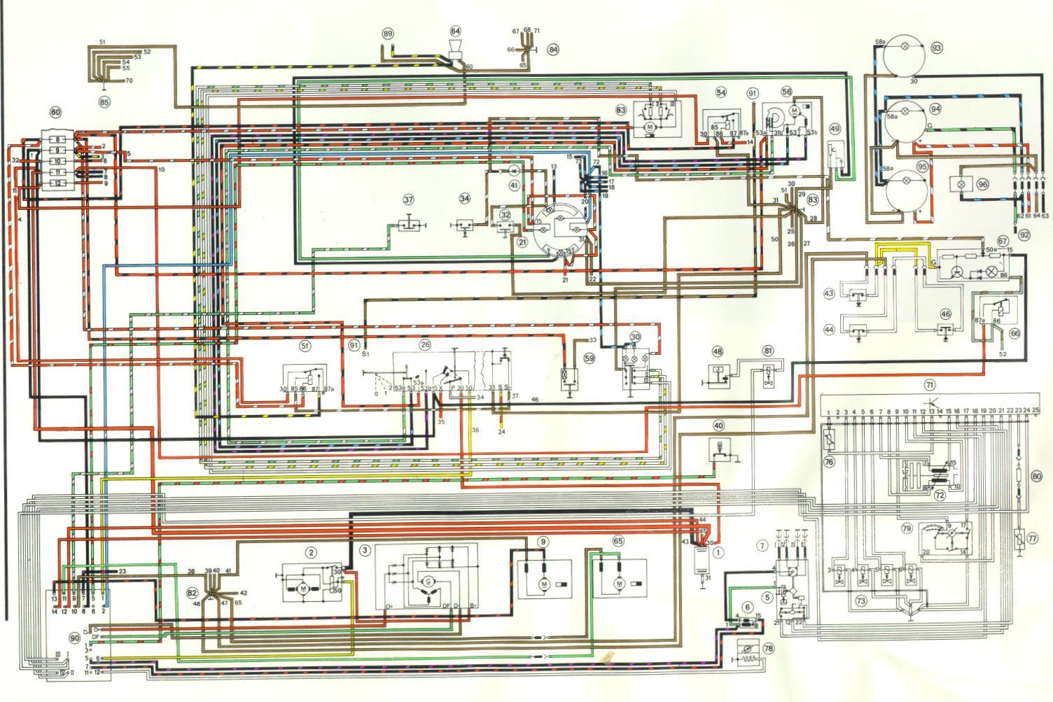

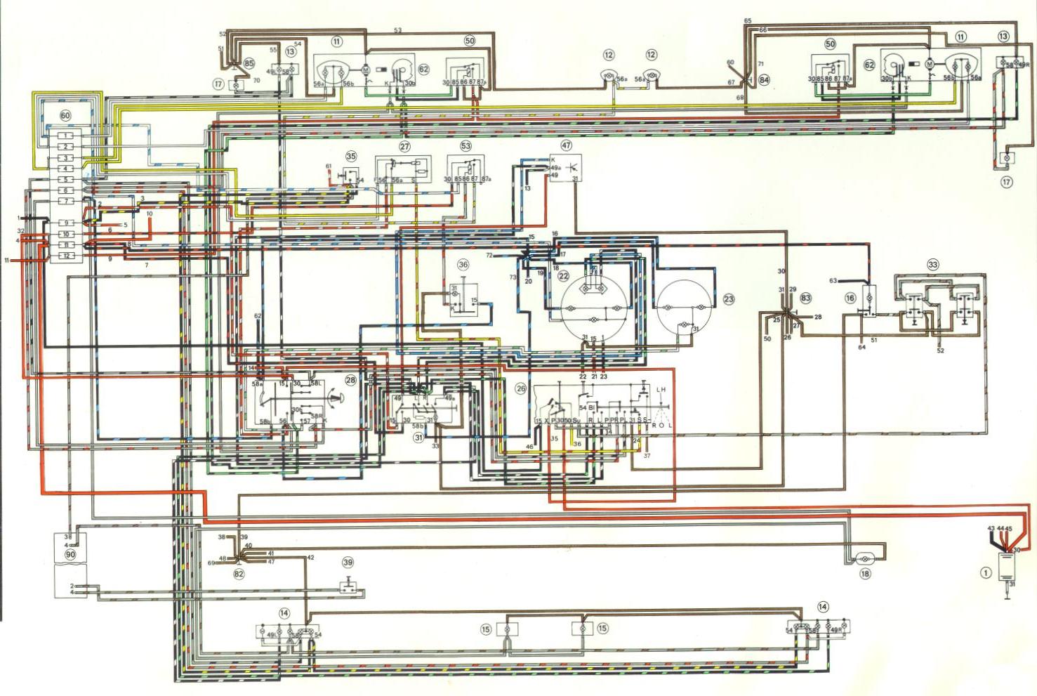

For some reason I've been blowing the 7.5 amp fuse which is connected to the red wires in the first pic. Not sure why or what could be causing this. Using the engmann panel btw. What do these wires go to? For some reason now I cant get anything to work. no dash lights nothing. Was working fine yesterday. Do these wires have anything to do with the coil?
The second pic shows the black wires which should be connected to the coil. Ive had some problems before with the coil wires. Had a short in one of them so I reran the wire and havent had a problem until today. Now for some reason that fuse keeps popping. What am I missing here?? sorry for the explanantion but I am really really not an electrical guy, and im actual quite amazed that ive gotten this far. Can someone help me out? Thanks

The problem is not with the fuse panel. The Engman panel does not conduct electricity. The second pick needs a connector on the wire. That looks like fuse 11. It controls lots of things like the headlight movement. See the attached diagram. trace all your wires out. You problably have some worn insulation some where...

messix   what fuse position is blowing?   May 15 2011, 06:55 PM
matteyp   It would be 11 and also I believe 9   May 15 2011, 07:49 PM
messix   It would be 11 and also I believe 9 it's blo...   May 15 2011, 08:14 PM
matteyp   I think there's two separate problems there. I...   May 15 2011, 08:36 PM
messix   use your diagram and isolate   May 15 2011, 08:44 PM
matteyp   Diagrams really don't help. Like I said I...   May 15 2011, 08:55 PM
kg6dxn   Look here... Bottom line, look at all the wires an...   May 15 2011, 09:00 PM
