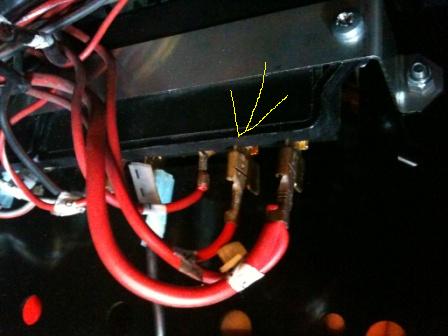

For some reason I've been blowing the 7.5 amp fuse which is connected to the red wires in the first pic. Not sure why or what could be causing this. Using the engmann panel btw. What do these wires go to? For some reason now I cant get anything to work. no dash lights nothing. Was working fine yesterday. Do these wires have anything to do with the coil?

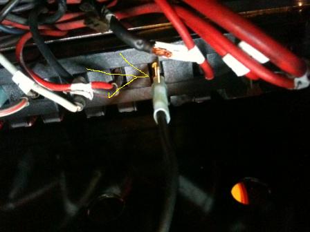

The second pic shows the black wires which should be connected to the coil. Ive had some problems before with the coil wires. Had a short in one of them so I reran the wire and havent had a problem until today. Now for some reason that fuse keeps popping. What am I missing here?? sorry for the explanantion but I am really really not an electrical guy, and im actual quite amazed that ive gotten this far. Can someone help me out? Thanks

Look here... Bottom line, look at all the wires and insulation for wear and chafing...
http://bowlsby.net/914/Classic/zTN_Elect_73FuseIndex.pdf

messix   what fuse position is blowing?   May 15 2011, 06:55 PM
matteyp   It would be 11 and also I believe 9   May 15 2011, 07:49 PM
messix   It would be 11 and also I believe 9 it's blo...   May 15 2011, 08:14 PM
matteyp   I think there's two separate problems there. I...   May 15 2011, 08:36 PM
messix   use your diagram and isolate   May 15 2011, 08:44 PM
matteyp   Diagrams really don't help. Like I said I...   May 15 2011, 08:55 PM

Bartlett 914   What year is your car? I have a 75. I also has fus...   May 18 2011, 05:09 PM
matteyp   Car is a 73 1.7 d-jet. #9 always blows when I turn...   May 18 2011, 08:18 PM
kg6dxn   Car is a 73 1.7 d-jet. #9 always blows when I tur...   May 18 2011, 10:12 PM
matteyp   Well here's the story guys, took the car to Ac...   May 23 2011, 12:30 PM
tradisrad   My first question is did the car stay running befo...   May 23 2011, 02:26 PM
matteyp   The engine ran but its never been run with the D-J...   May 23 2011, 02:40 PM
Tom   Matt, Has the fuel pump ever worked for you? I...   May 23 2011, 07:04 PM
Tom   Looking at the Haynes manual, it looks like jumper...   May 23 2011, 09:31 PM
matteyp   I was told that I should jump the first left most ...   May 24 2011, 01:38 AM
Tom   Matt, The first connections on the left of th...   May 24 2011, 10:23 AM
