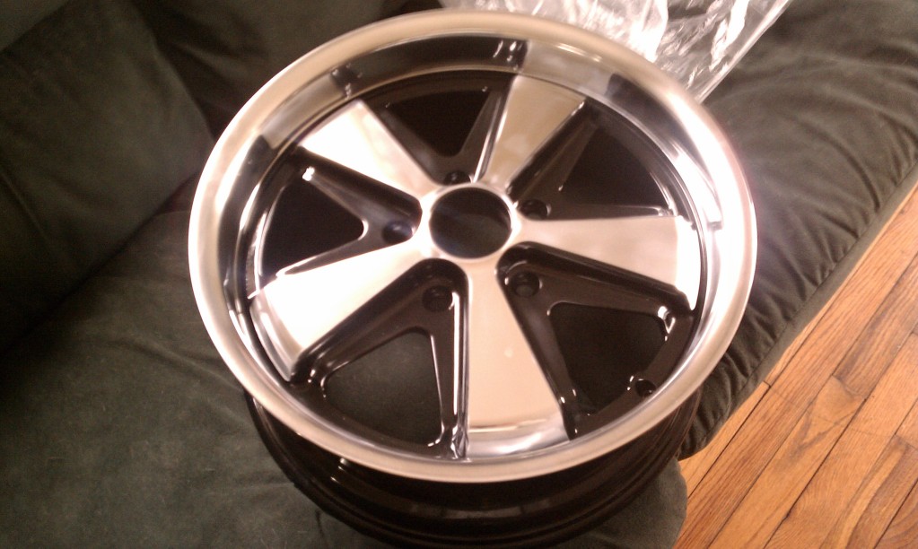

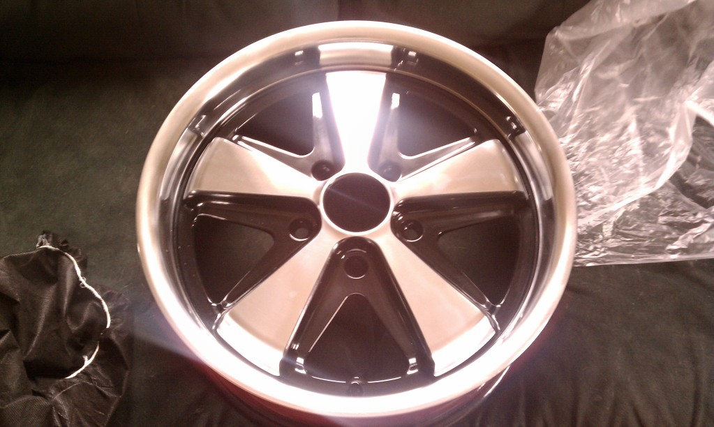

Yeah, I kinda like the looks of them too. The petals are narrower and the corners look a little sharper. And 17" is a plus too. If you get a chance to get a closer pic I'd like to see it.
tscrihfield
post May 16 2011, 04:45 PM
Drive Fast and Take Chances
Posts: 643
Joined: 8-September 10
From: Amelia Ohio
Member No.: 12,156
QUOTE(Gint @ May 15 2011, 11:13 PM) *
17's were a must due to more tire sizes/types to choose from for performance tires.
(IMG:http://www.914world.com/bbs2/uploads_offsite/i163.photobucket.com-12156-1305585937.1.jpg)
(IMG:http://www.914world.com/bbs2/uploads_offsite/i163.photobucket.com-12156-1305585937.2.jpg)
These are pretty close prior to the tires going on. Let me know if this helps. I can try to get a better picture if you need.
