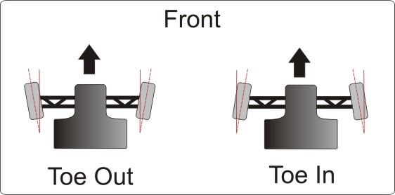

Remember it's the distance from the *outside* of the car to the wheel... So toe in will have a greater distance from the string to the front half of the rim:
vs toe out which will have less distance from the string to the front of the rim (in relation to the back of the rim):
-Aaron

QUOTE(yeahmag @ May 17 2011, 11:09 AM) *
-Aaron
Just to clarify, your words make sense but your stick figures threw me because I usually see figures with front of car at top of diagram. (IMG:style_emoticons/default/smile.gif)
Look at your feet on the ground. Pivot on your heels, move your toes in. Toe in.
I walk like a duck, I like a little toe out so I can turn quicker. (IMG:style_emoticons/default/biggrin.gif)
