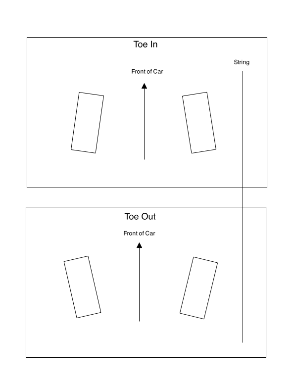

how to string align from smart racing.
I am a little confused on his instruction where he says " Toe-in: the measurement is longer on the leading edge of the
wheel than the trailing edge of the wheel." This seems backwards to me and he has it switched with "Toe-out: the measurement is shorter on the leading edge of the wheel than the trailing edge of the wheel." Is he correct with his terminology?

QUOTE(tradisrad @ May 17 2011, 07:19 AM) *
See the attached diagram. Remember you are measuring from the OUTSIDE of the car, not the centerline.
