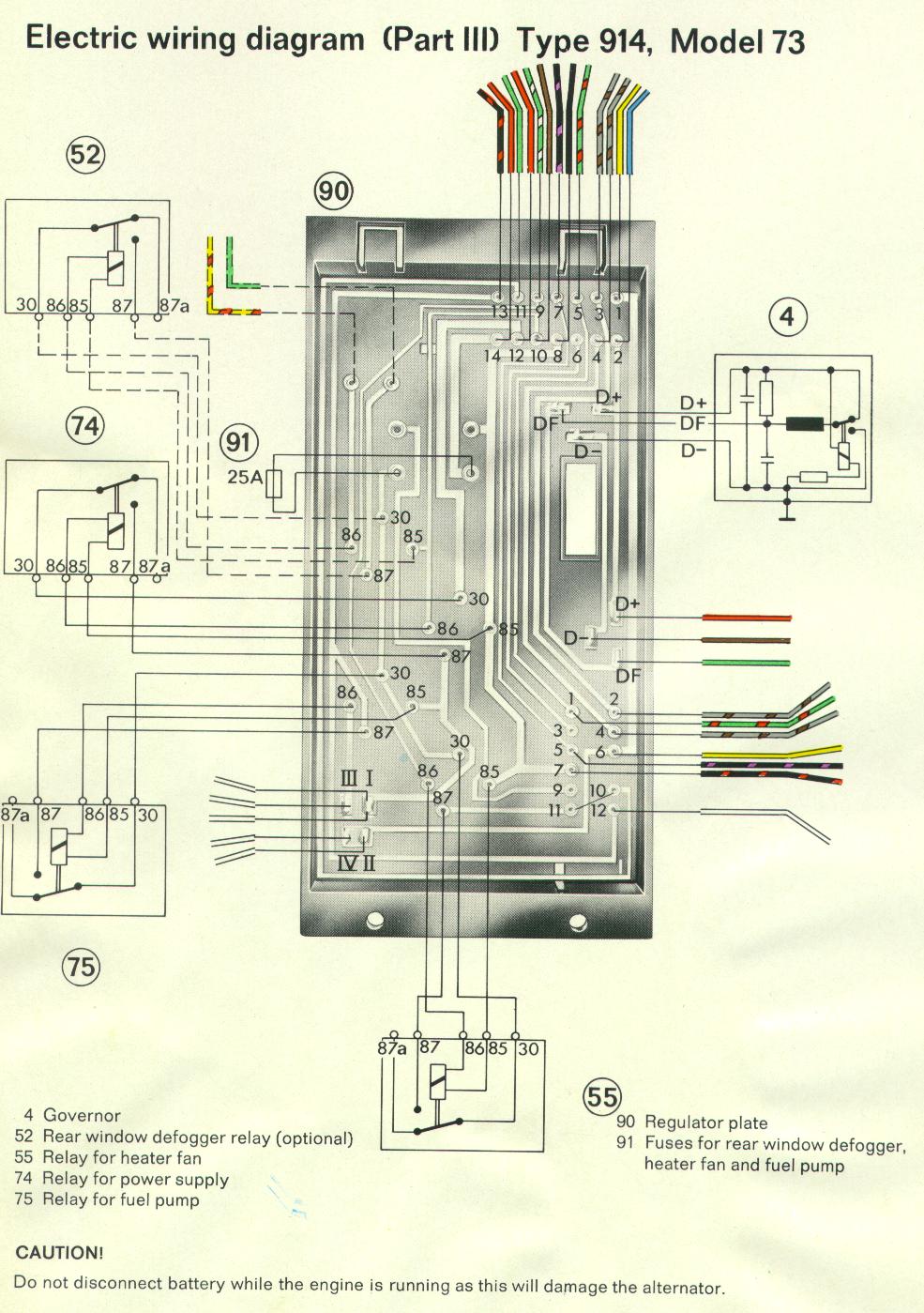

yellow wire to the relay board is from the ignition switch (26)(relay board pin 1; 14 pin connector), yellow wire leaving the relay board goes to the starter (2)(relay board pin 6; 12 pin connector). The 14 pin connector is "keyed" and can only go on one way; the 12 pin connector can easily and accidentally be shifted a set of pins when reinstalling
AWESOME! That is exactly what I needed!
