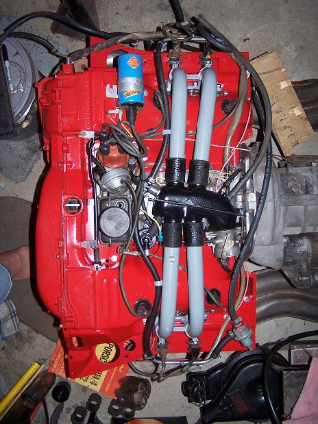

Here's what the fuel lines on my 1.7L DJET look like for reference.

Spoke   Here's what the fuel lines on my 1.7L DJET loo...   May 22 2011, 09:56 AM
