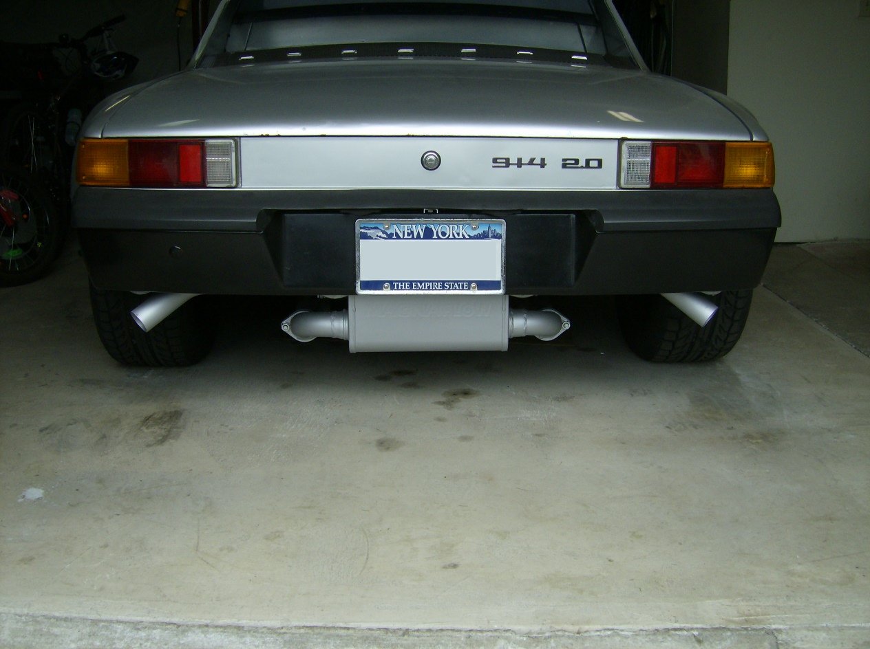

Update: Finished up the exhaust. This is a Maganflow Tru-X crossflow muffler. Fits perfectly between the headers. Equal length exhaust now for both sides. A little droney at 2000 rpm but not bad at 3000 rpm (highway speed). About $200 in materials and easily 10 hours of labor getting everything just right.
I used Rustoleum 2000 deg primer and paint on the muffler. Looks good so far. I'll try to update next year after I get some miles on it.
