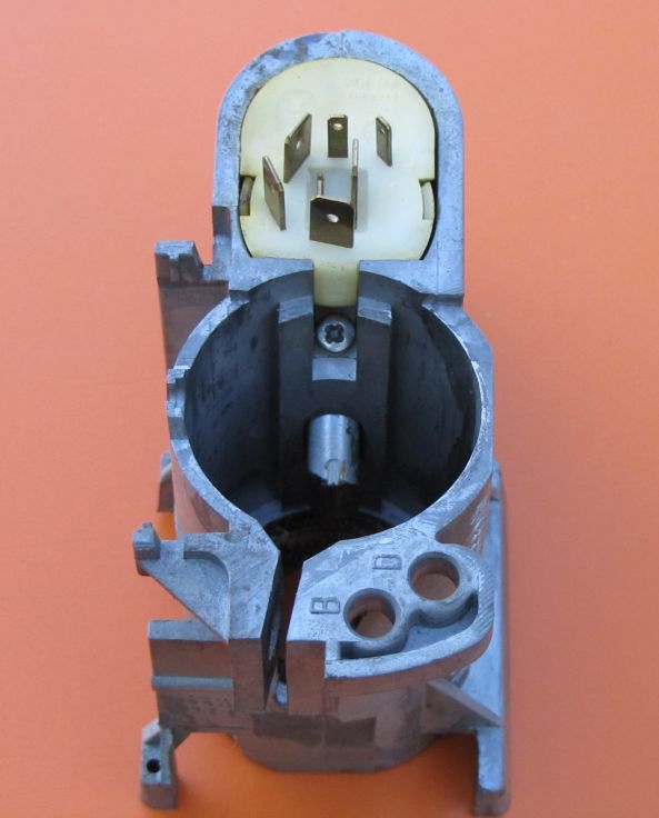

McMark   Joe, some pictures of the box and part would be ex...   May 26 2011, 10:53 AM
r_towle   Joe, some pictures of the box and part would be e...   May 26 2011, 02:56 PM
porscheless   Here it is! It is for a 76, which I think goe...   May 26 2011, 03:50 PM
FlatSix   That photo was just too much for me. I've just...   May 27 2011, 02:34 AM
SLITS   3 different switches '69 - mid '72 .... h...   May 27 2011, 07:01 AM
FlatSix   I ordered the same part number as in the picture. ...   May 27 2011, 10:31 AM
KELTY360   This link will take you through it step by step. ...   May 27 2011, 11:02 AM
r_towle   your at the wrong end ,,,, Remove the plastic col...   May 27 2011, 11:10 AM
FlatSix   The Pelican article was good but a little vauge fo...   May 27 2011, 12:23 PM
FlatSix   The good news is that the old switch was cracked. ...   May 27 2011, 12:26 PM
