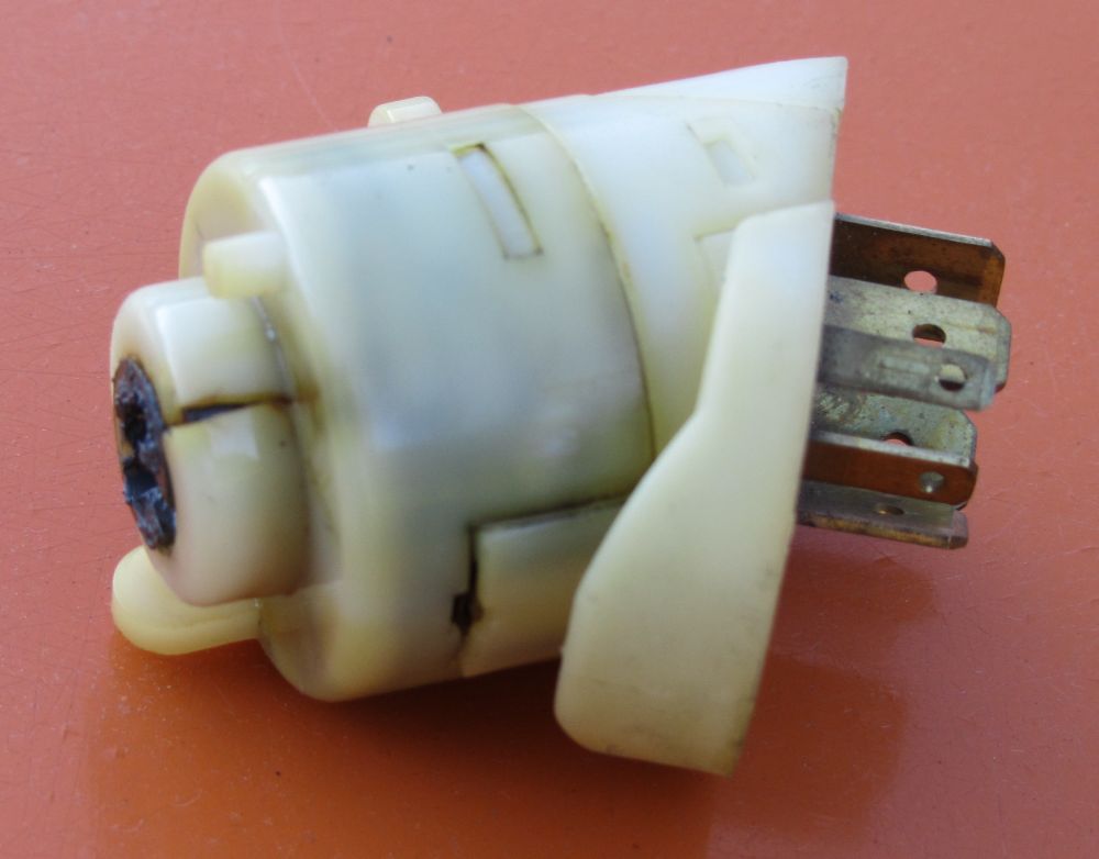

Rockaria   has anyone mentioned checking the ignition switch....   May 24 2011, 09:51 PM
FlatSix   Christopher, Having thought about this a bit now, ...   May 26 2011, 04:10 AM

porscheless   Here it is! It is for a 76, which I think goe...   May 26 2011, 03:50 PM

SLITS   3 different switches '69 - mid '72 .... h...   May 27 2011, 07:01 AM
FlatSix   I ordered the same part number as in the picture. ...   May 27 2011, 10:31 AM

FlatSix   The good news is that the old switch was cracked. ...   May 27 2011, 12:26 PM
