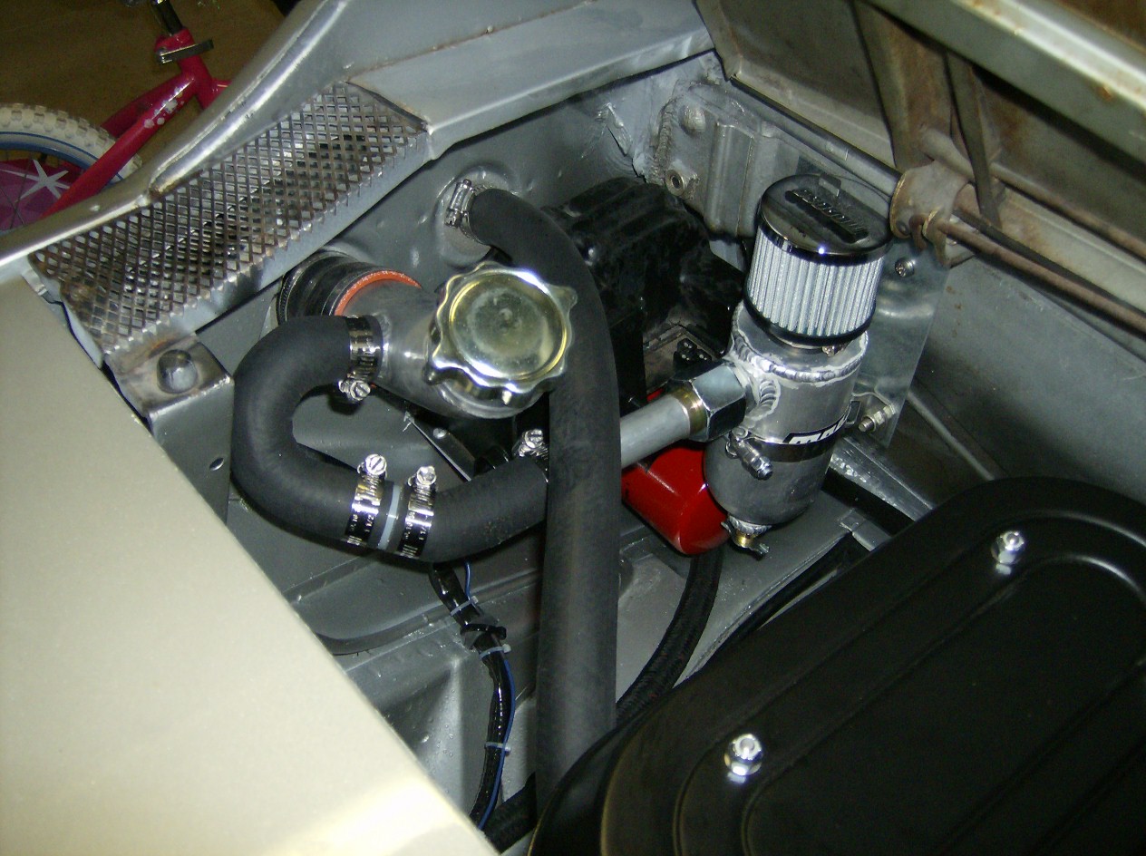

Update: Finally done with the breather. There's really no good place to mount it. In the trunk was out because I carry stuff back there. I cut a 16 gauge plate, bolted the breather to it and then screwed the plate to the firewall.
Fitting on the breather is -16AN so I picked up some aluminum tube, swedged it to a straight fitting and threaded it on to the breather.
Hose is from my FLAPS where they let me wander the radiator hose rack until I found what I needed. This one is a Dayco part # B71540 from a Nissan/Datsun/Suzuki that I cut and spliced to get the right angle I needed.
