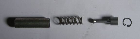

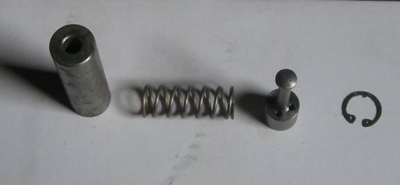

I used to build scissor lifts and the big thing I don't like is the lack of automatic safety locks. It uses pins that could be forgotten if one was in haste.
I hope they use in-line hydraulic fuses and I would definitely ask about this. A hydraulic fuse is a last ditch safety device in the event of a cut hose, etc. I also would ask if this was an ALI ( www.autolift.org/ ) certified lift.
Not much to a hydraulic fuse (pics), it can be all that stands between you and being squashed like a bug, but it doesn't replace a physical safety lock device.

QUOTE(Mark Henry @ Aug 22 2010, 01:16 PM) *
I'm curious about these " pins " you are talking about. On my Ammco brand scissor lift it has an automatic safety latch/lock. As the lift raises there is a center bar that has four notches cut into the bar. As it raises there is a spring loaded safety catch which is another heavy steel piece. As the lift gets past each notch this safety latch springs into position automatically. Now it is true that if you stop the lift in between these four notches there would be nothing but hydraulic pressure holding the car up but I am always aware to make sure I stop the lift in one of those four positions. I take it from your comment that not all scissor lifts have this auto latch/lock feature ? To lower my lift I have to raise it a little bit to take the pressure off the catch, pull a handle similiar to a bicycle brake lever to disengage/pull back the safety latch and hold it open and lower the lift. I feel safe with this arrangement are you familiar with this setup ? Would be interested in your opinion on it.
