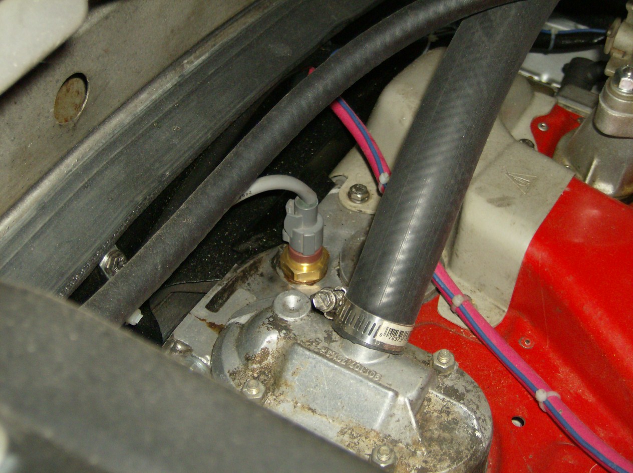

My solution to turn the oil cooler fan on:
Honda Civic/Accord/etc. radiator fan switch from Autozone, $20. Wells part number TU197 with 18 x 1.5 metric thread. Turns on at roughly 93 deg C. Off somewhere around 89 deg C.
Pigtail for same radiator switch from the local pic and pull, $1.50
The switch threads into where the idiot light was situated. I used the adapter that was in this spot for the combo oil pressure/idiot light switch now mounted next to the fan.

Nice continued use of NARP parts!!! (IMG:style_emoticons/default/lol-2.gif)
Seriously, good idea.
