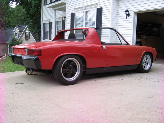

I finally took it on the long awaited first test drive Sunday. Drove it about 2 miles on a back road. The smoothness and sound from the engine was incredible. Only took it to 6k rpm as I didn't have the speed sensor hooked up required for Vtec to engage. Even so the car felt strong. A 4 wheeled motorcycle is the best way to describe it. 9k rpm with Vtec is gonna be unbelievable.
I'm still worried about the cooling system. Its gonna take a much longer drive to evaluate that.
Bodywork and paint are next. Trying to decide between 2 paint schemes
1) Andy Warhol BMW M1 Art Car copy
2) BMW Imola red w/ Silver bumpers and Fuchs.
The car in its current state.
