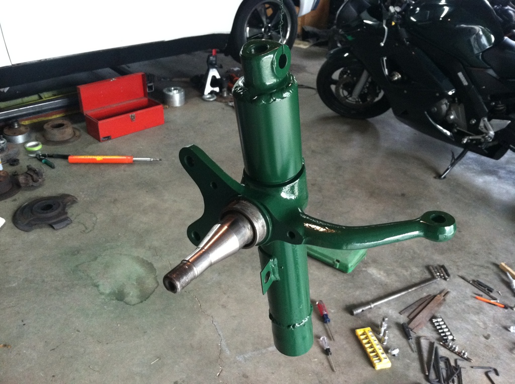

tscrihfield   The last photo I posted of my entire car the suspe...   Oct 1 2011, 09:08 PM

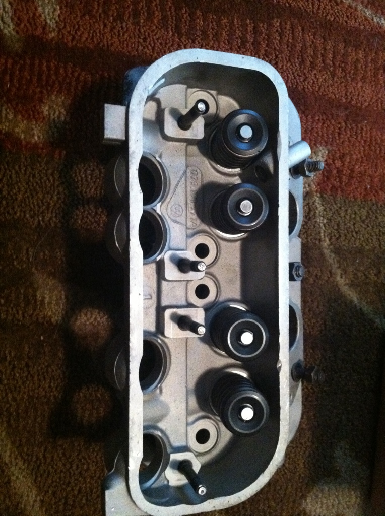

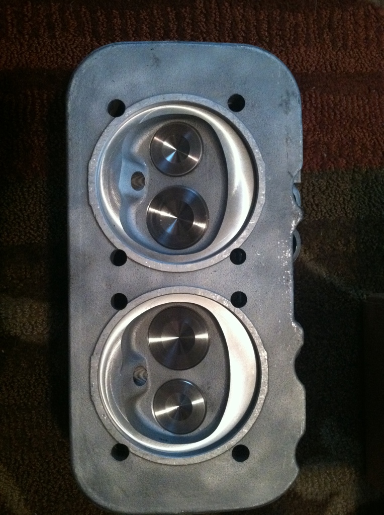

tscrihfield   Well I finally got some work done over the past we...   Oct 18 2011, 06:18 PM
