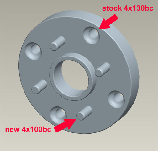

just a word of caution: it gets expensive and a PITA to be different with your wheel choice...I'm running 16x7's with a 4x100 bolt pattern, since I have no flares, I cannot run spacers or adapters so I re-drilled my hubs/rotors...I just picked up a set of 4 16x9's with the correct 4x130 bolt pattern, but I'd have to run 2" flares on the car and right now I don't want to touch the body.
