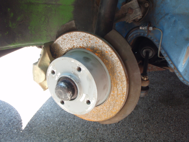

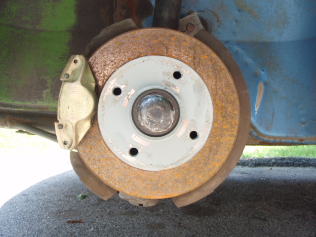

I have just orderd some wheel spacers for the front of my 914. They are 4 X 130 20mm spacers. These should bring the front wheels to about the same track as the rear, filling in the front wells. I am just doing it for looks. (IMG:style_emoticons/default/smile.gif)
My question is the stock lug bolts are 38mm R14 ball seat. With these spacers I need to add the 20mm length. The closest I have found are radusadirect.com and they are 58mm R14 ball seat. I was about to order until I read some threads that stated studs and nuts are better???
what is the benefit? Are the 58mm bolts dangerous??
opinions???

These things fit like a glove! I mean there is not even a hundredth of an inch. The press on and then you have to tap them gently all the way around until they are completly tight against the rotor. They dont budge, and with the ring on there, the tire mounts just like it always did. No fuss.
I highly recomend these for any 4 lug teener out there. They are bitchin (IMG:style_emoticons/default/aktion035.gif)
