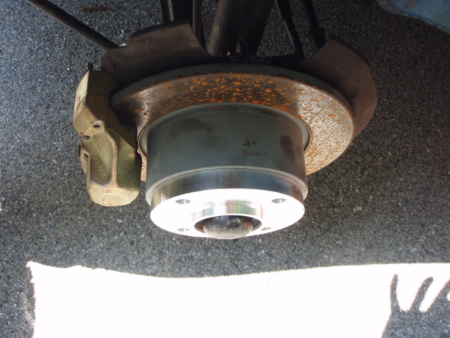

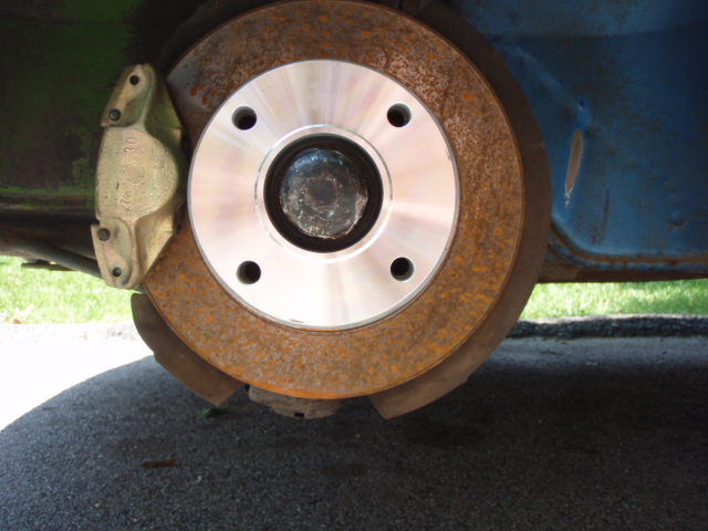

I have just orderd some wheel spacers for the front of my 914. They are 4 X 130 20mm spacers. These should bring the front wheels to about the same track as the rear, filling in the front wells. I am just doing it for looks. (IMG:style_emoticons/default/smile.gif)
My question is the stock lug bolts are 38mm R14 ball seat. With these spacers I need to add the 20mm length. The closest I have found are radusadirect.com and they are 58mm R14 ball seat. I was about to order until I read some threads that stated studs and nuts are better???
what is the benefit? Are the 58mm bolts dangerous??
opinions???

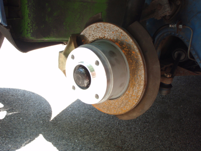

jsayre914   OMFG These things fit like a glove! I mean the...   Jul 12 2011, 01:41 PM
jsayre914   Install Shots   Jul 12 2011, 01:43 PM
jsayre914   Front Before [color=#000066][size=3]Front After...   Jul 12 2011, 01:46 PM
jsayre914   Another Before [size=3][color=#330099]Another A...   Jul 12 2011, 01:48 PM
