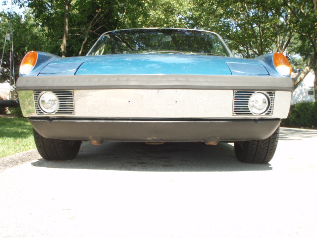

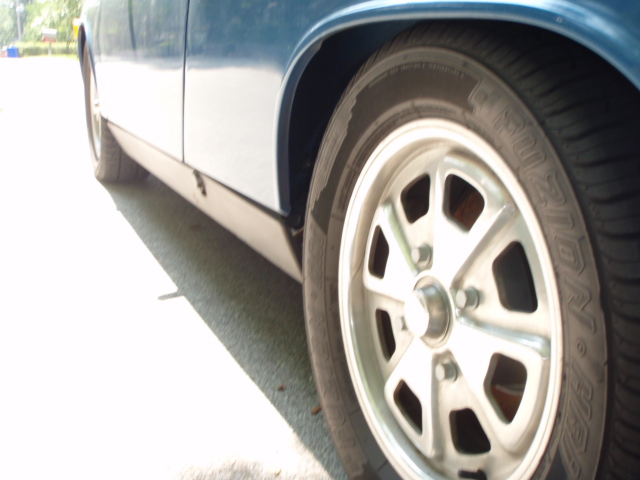

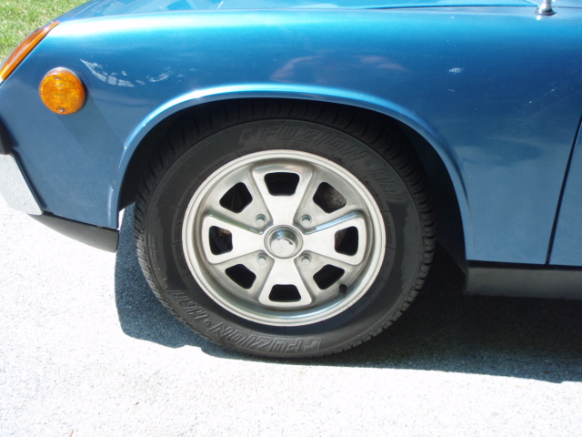

jsayre914   OMFG These things fit like a glove! I mean the...   Jul 12 2011, 01:41 PM
jsayre914   Install Shots   Jul 12 2011, 01:43 PM
jsayre914   Front Before [color=#000066][size=3]Front After...   Jul 12 2011, 01:46 PM
jsayre914   Another Before [size=3][color=#330099]Another A...   Jul 12 2011, 01:48 PM
jsayre914   Rear tire clearence on my car is tight, im rockin ...   Jul 12 2011, 01:53 PM
jsayre914   Last Shots   Jul 12 2011, 01:56 PM
jsayre914   And the Kitty Update :beer2:   Jul 12 2011, 01:59 PM
