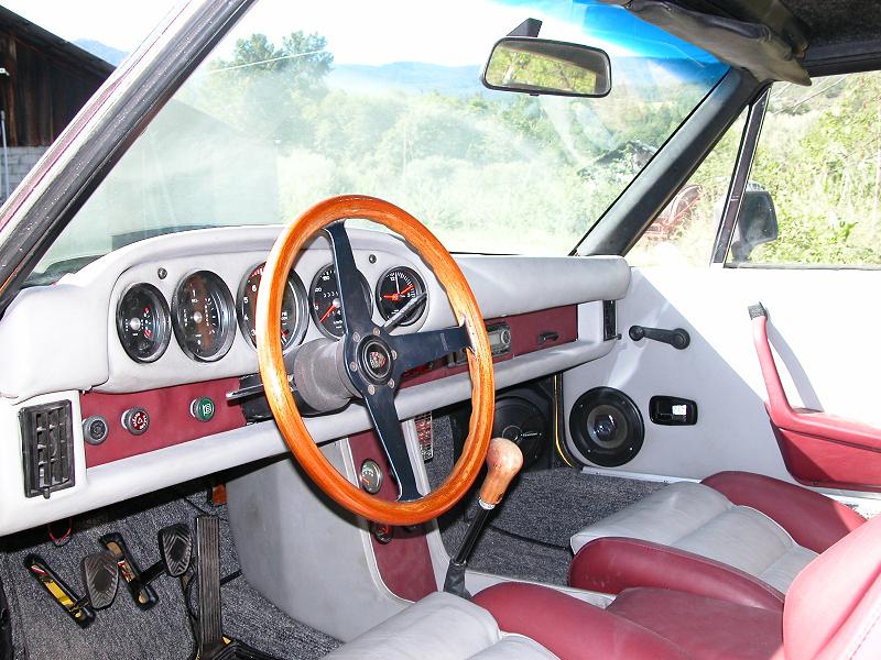

Here's my Getty dash. It wasn't too hard to put in, but be prepared to figure out how to fasten it because there are no mounting tabs, studs or anything. I screwed it down around the front border under the windshield, but this required removing the windshield.
![]() The Getty dash overhangs the original dash by about 1" on the "cabin" edge. I covered mine in gray synthetic leather. I also had a local upholstery shop create 911 style door panels for me. The Getty dash, the driver's door pocket, the lower original dash and the passenger door pull were all done by a dashboard specialist in my area. HTH Mike |
