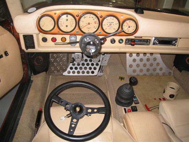

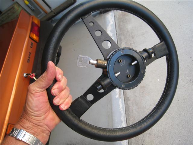

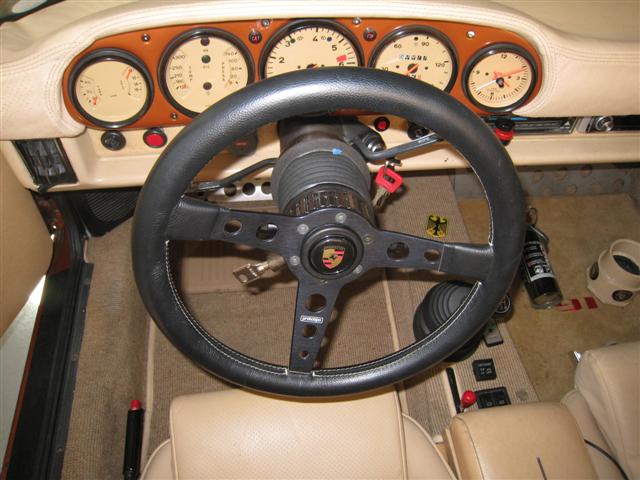

I just installed the Snap-Off quick release, works great and the horn works too. The Street Snap-Off doesn't require disconnecting the horn wire every time you remove the wheel.
Gonna have the MOMO hub adapter shortened this week, but not a big problem.

jim_hoyland   I just installed the Snap-Off quick release, works...   Jul 18 2011, 08:31 PM
jim_hoyland   Side views, the hub will be shortened....   Jul 18 2011, 08:33 PM
Randal   Side views, the hub will be shortened.... Man,...   Jul 18 2011, 08:35 PM
