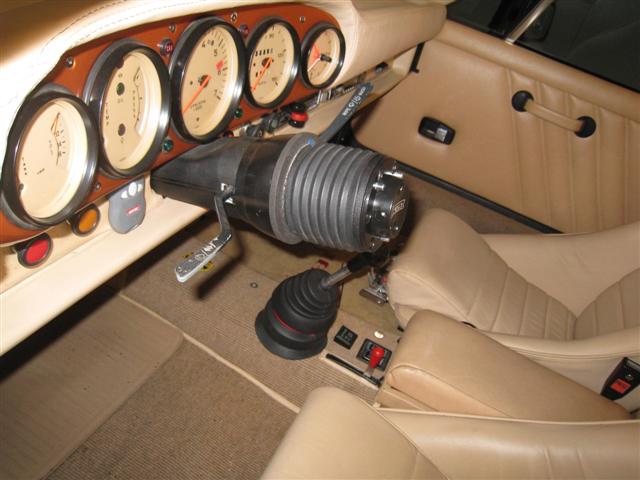

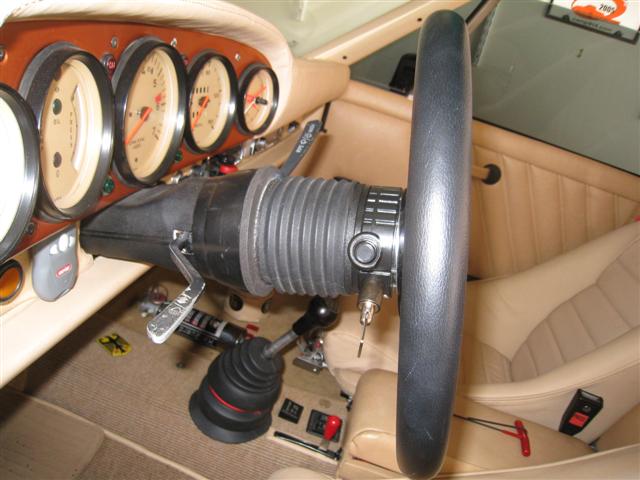

jim_hoyland   I just installed the Snap-Off quick release, works...   Jul 18 2011, 08:31 PM
jim_hoyland   Side views, the hub will be shortened....   Jul 18 2011, 08:33 PM
Randal   Side views, the hub will be shortened.... Man,...   Jul 18 2011, 08:35 PM
gms   I have a snap-off, I think it is the race version....   Jul 19 2011, 07:32 AM

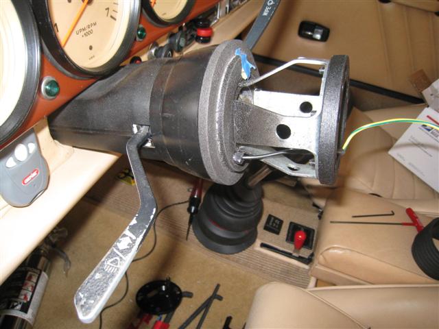

tomeric914   I ended up using my right angle die grinder and a ...   Mar 23 2013, 09:29 AM
tomeric914   Here's a view from the side: Installs and r...   Mar 23 2013, 09:32 AM
tomeric914   Dave, this photo is for you. My view may be diffe...   Mar 23 2013, 09:36 AM
Harpo   Thanks, looks good. Now to just wait patiently un...   Mar 23 2013, 11:18 AM
