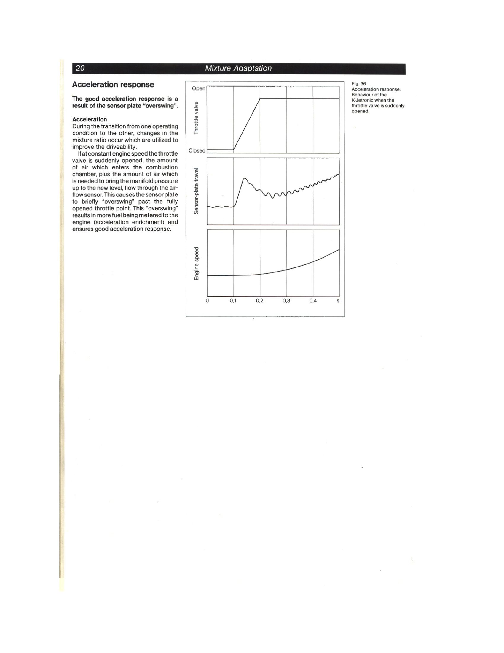

Here's a diagram describing how it enriches the mix when you stomp on the gas:
I'm not qualified to comment on how a high duration camshaft might affect the operation of the sensor, but it is clear that strong pulsations in manifold air flow might. I thought that valve overlap acted to mitigate exhaust gas resonance, permitting more fuel to enter the combustion chamber? In the Bosch K-jet material they mention overlap as an important part of their performance/economy/emissions strategy.
