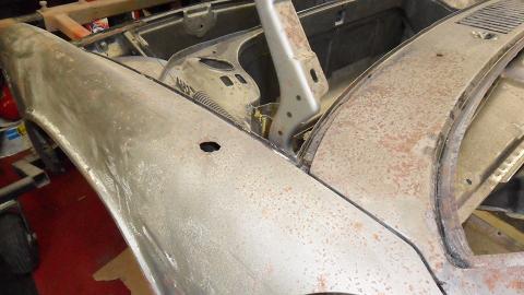

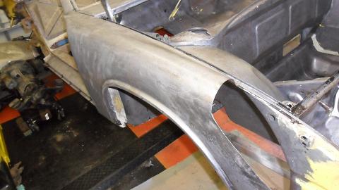

A couple pics for your enjoyment (IMG:style_emoticons/default/smile.gif) First two are before grinding, last 3 are after grinding/Ospho

993inNC   Well my son decided he wanted to work on "his...   Jul 25 2011, 05:16 PM

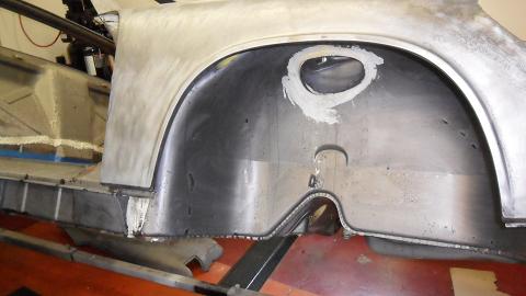

dlee6204   Got some more work done today. I got the jack poi...   Feb 4 2012, 03:49 PM
dlee6204   The story was the same for the other side...   Feb 4 2012, 03:51 PM

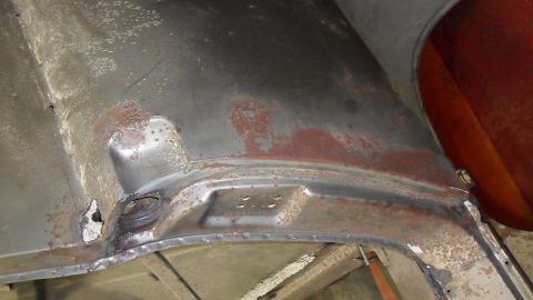

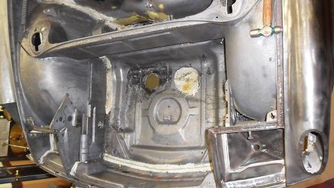

dlee6204   Update: I've been working on a lot of littl...   Feb 23 2012, 08:52 PM
dlee6204   The front trunk floor also has some thin metal wit...   Feb 23 2012, 08:58 PM
dlee6204   I did some work on the lower firewall too. ...   Feb 23 2012, 09:12 PM
dlee6204   Oh and who says there aren't enough spot welds...   Feb 23 2012, 09:14 PM
