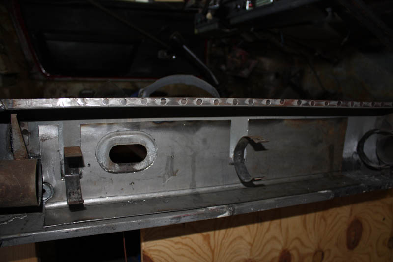

post Aug 14 2011, 03:55 PM
Posts: 413
Joined: 24-February 06
From: Atlanta ,GA
Member No.: 5,628
It has been a while since my last post and I have been working but have not made any substantive progress until today. Today was all about sleeving the inside of the passenger side long. If you look at several of my previous posts you will see that I removed a significant portion of the bottom of the inner long because of rust. Following Jeff Hails advice in the Bring out the Dead thread I decided to sleeve the long to strengthen my welds. This is the piece I fabed today from 16g. There are two notches at the top that will be filled with the pieces that came out of them once the piece is welded in. All that is left to close up this side is to buy some 18g and fix the baffle at the front of the long (not quite visible at the right of the pic but it is in several other shots).
