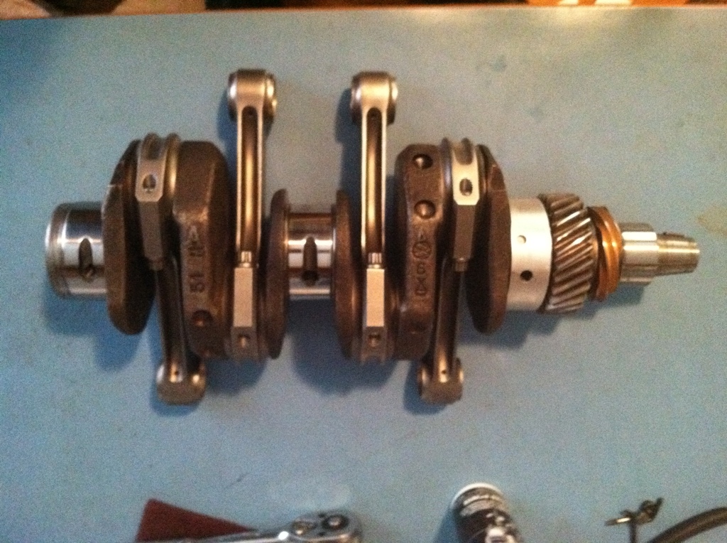

Again, a while since the last post. As of now I have finished the Megasquirt it is just waiting on the rest of the engine to get finished.
This afternoon I put the crank assembly together.
(IMG:http://www.914world.com/bbs2/uploads_offsite/i163.photobucket.com-12156-1313710752.1.jpg)
Can't wait to get the rest together!
