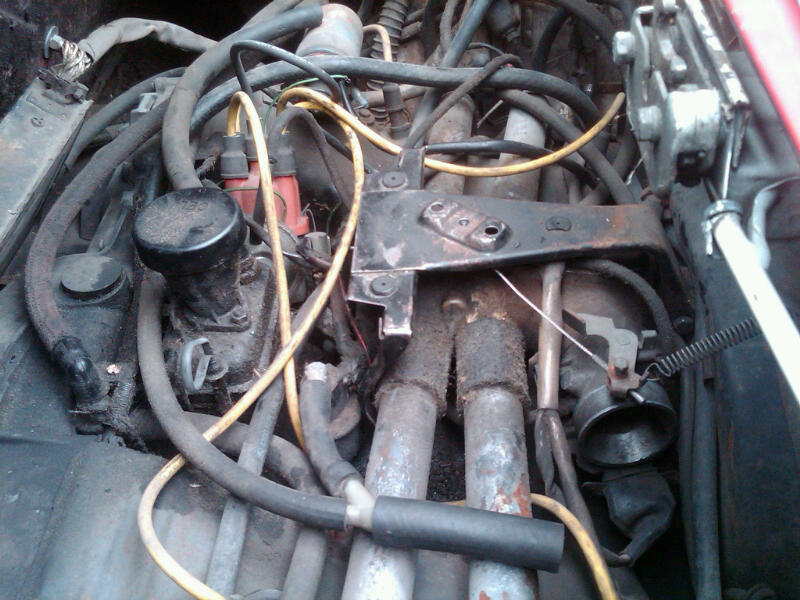

some pix - 1st is from the port side looking in

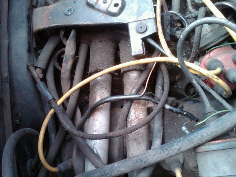

2nd is starboard side looking at the 'spare hoses with bolt plugs' in them

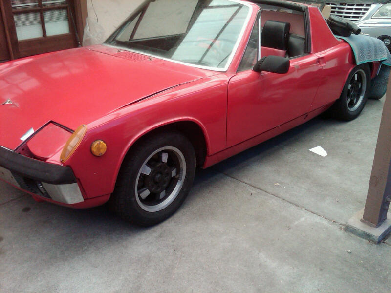

3rd is the 'pride and joy'
History is that this is a bit of a barn find - it was in storage and the guys at the yard decided to help themselves to as many bits as they could unscrew - so there are things not there that I might not notice since I'm not that familiar with the teener. Some things I do know are missing are the headlamp motors (cut the wires to get them out), and various trim bits.
She's had a bit of a shunt to nose and the hood is bent in the middle a bit - so I'll replace that, the front bumper, and the front struts asap.
still, it starts, runs, makes good noise. with a bit of work, should be just fine.

swl   There are a few things that are just out of site t...   Aug 21 2011, 07:56 PM

SirAndy   I don't see your MPS anywhere? And no air filt...   Aug 21 2011, 09:31 PM
Elliot Cannon   I don't see your MPS anywhere? And no air fil...   Aug 21 2011, 09:37 PM
tadink   I don't see your MPS anywhere? And no air fil...   Aug 21 2011, 10:37 PM
