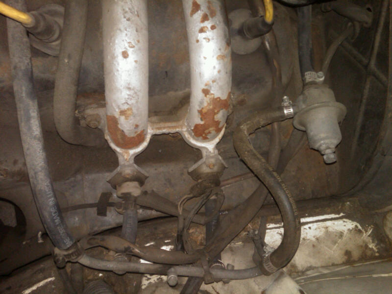

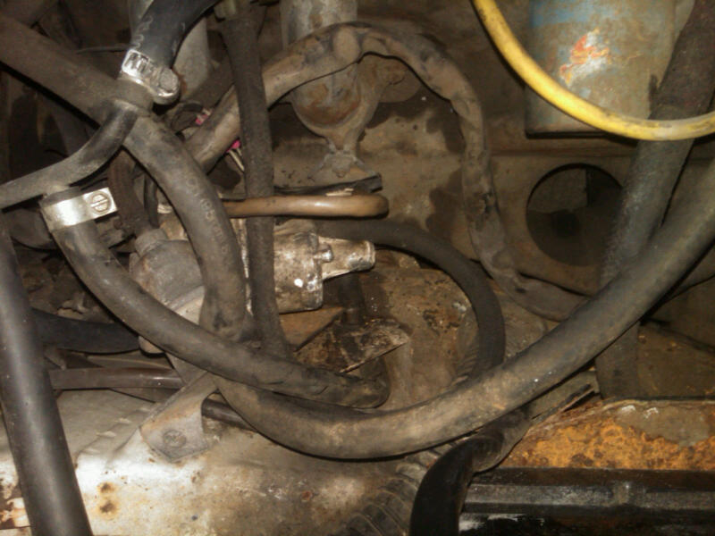

There are a few things that are just out of site that might explain a lot
Can you take another picture that would show that which is immediately below the frame of the current picture #2. That is where the MPS and the decel valve are. Just outboard of the intake runners.

QUOTE(swl @ Aug 21 2011, 06:56 PM) *
couple more photo's - one from each side....
