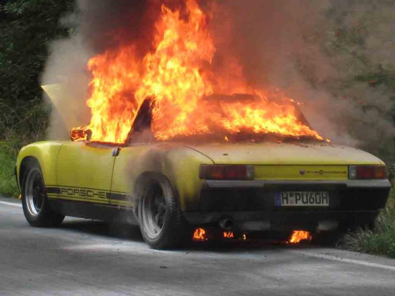

I don't see your MPS anywhere? And no air filter? (IMG:style_emoticons/default/confused24.gif)
Some of them "plugged" hoses should be going to the air filter.
Also, that looks like the wrong fuel hose and most certainly the wrong hose-clamps. That is an engine fire waiting to happen.
(IMG:style_emoticons/default/blink.gif)

My LEAST favorite 914 picture.
