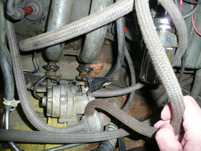

I don't see your MPS anywhere? And no air filter? (IMG:style_emoticons/default/confused24.gif)
Some of them "plugged" hoses should be going to the air filter.
Also, that looks like the wrong fuel hose and most certainly the wrong hose-clamps. That is an engine fire waiting to happen.
(IMG:style_emoticons/default/blink.gif)

Gotta agree Andy! That whole area is a dogs breakfast. Not only what you pointed out on the fuel hose but is that actually the fuel rail hanging in mid air with long sections running to the injectors? and one of those hoses is routed through the MPS bracket?
The MPS has to be around somewhere. DJet won't run without it. There is something hidden below the decel valve but it sure doesn't look like an MPS.
TD someone has really done a number on this car. You really need to sort it out before you go running that engine. There are enough folks here to help you through it and it won't be hard or terribly expensive. But it needs to be done.
Here is what that area should look like (the leaf is optional)
The decel valve is the small one on top and the MPS is the big one below. You can just see where the fuel rail goes. It is peaking out from under the left side of the mps.
