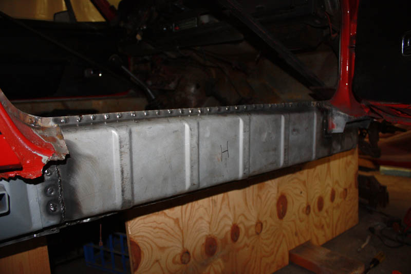

Didn't get that much done even though I worked at it all day but I do have the passenger side closed up!!. It still needs some grinding and the sill and lower door jamb.
Now my debate is do I open up the other side. It is not as bad off at the back as the passenger side but I really don't want to discover it needs done after I paint the car. On the other hand I hate to drill out all those perfectly good factory spot welds and replace them with my less optimal versions if there is nothing wrong with it. I wonder if anyone in the Atlanta area has a fiber optic camera that I could use? (IMG:style_emoticons/default/smile.gif)
Now for a couple of pics...
Heater tube back in
Everything welded up
