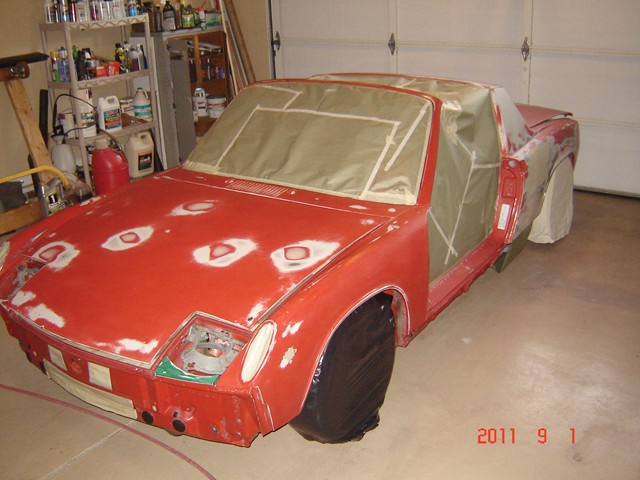

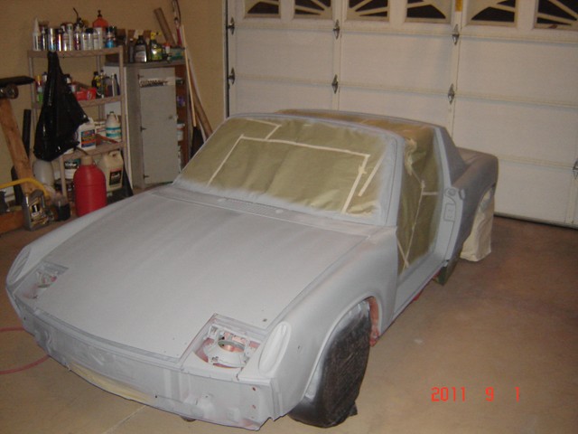

On target to get the car painted by the end of September. Base color will be white. Not sure yet about the bumpers, wheels, sails, etc.
Painting is a lot of freaking work. Good thing it's gonna be track car because I don't have the patience to make it perfect.
