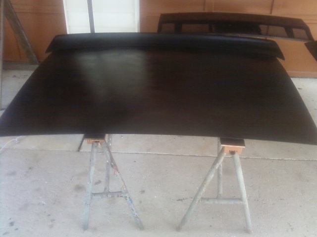

Here is the rear lid w/ spoiler.
(IMG:http://www.914world.com/bbs2/uploads_offsite/i921.photobucket.com-11654-1315093501.1.jpg)

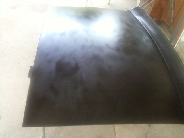

Here you can see the uneven paint.
(IMG:http://www.914world.com/bbs2/uploads_offsite/i921.photobucket.com-11654-1315093502.2.jpg)

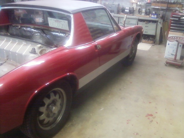

Applying the side stripes.
(IMG:http://www.914world.com/bbs2/uploads_offsite/i921.photobucket.com-11654-1315093502.3.jpg)

ripper911   Here is the rear lid w/ spoiler. http://www.914wor...   Sep 3 2011, 05:45 PM
bigkensteele   I would put a few more coats on and let it cure fo...   Sep 3 2011, 05:55 PM
