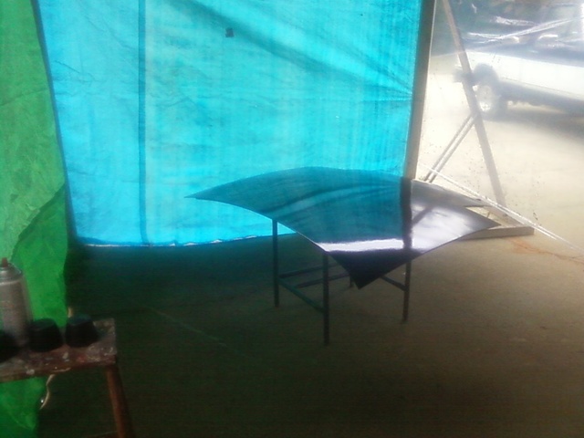

Well, we set up a temporary paint area to keep the wind out, and finally got the paint even, but I still made a spot on the front that will have to be sanded and painted again...
(IMG:http://www.914world.com/bbs2/uploads_offsite/i921.photobucket.com-11654-1315182886.1.jpg)

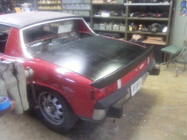

And here is the rear lid sitting on the car.
(IMG:http://www.914world.com/bbs2/uploads_offsite/i921.photobucket.com-11654-1315182887.2.jpg)
