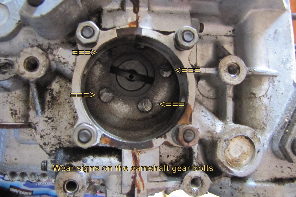

Valy   More work today and more surprises. Took off cylin...   Sep 4 2011, 07:47 PM

Vacca Rabite   Assuming you are going to put a non stock cam in t...   Sep 5 2011, 07:19 AM
Jake Raby   Yep, retention wire wear.. But if you do this job...   Sep 5 2011, 08:44 AM

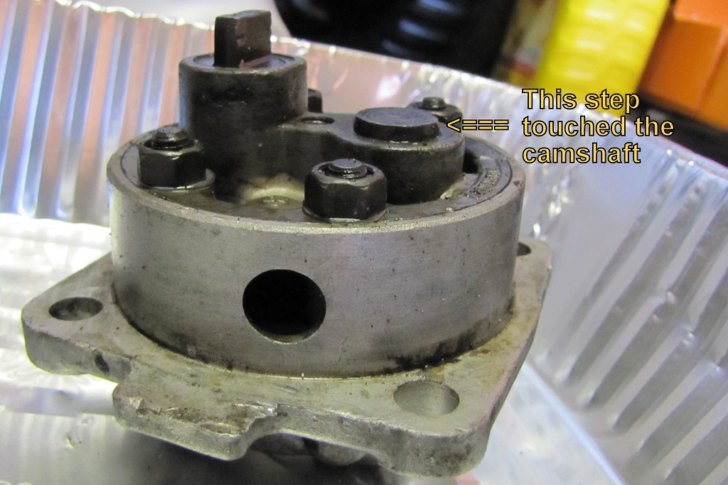

Valy   Oil pump is out :Qarl: It has some wear on the d...   Sep 5 2011, 04:22 PM
Jake Raby   The lowermost pic of the oil pump shows a failing ...   Sep 5 2011, 04:30 PM
Valy   The lowermost pic of the oil pump shows a failing...   Sep 5 2011, 05:15 PM
jcd914   The shaft in the pump should be flush with the...   Sep 5 2011, 07:14 PM

Jake Raby   There ya have it... What I said earlier.. This hap...   Sep 5 2011, 06:20 PM
