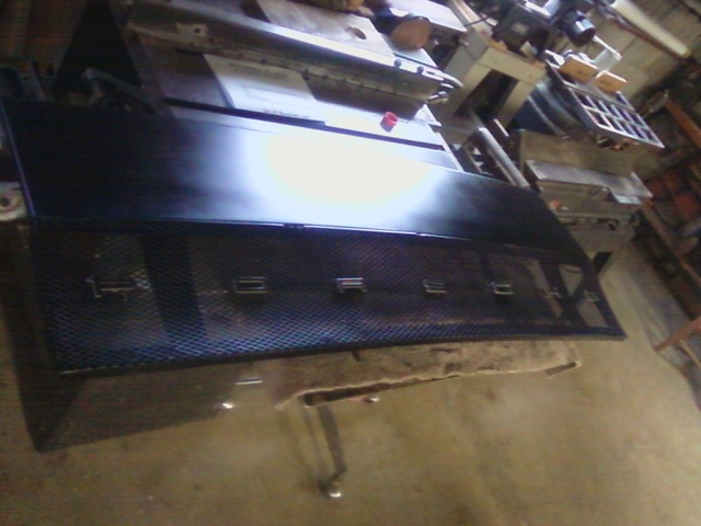

The repainted engine lid.
(IMG:http://www.914world.com/bbs2/uploads_offsite/i921.photobucket.com-11654-1315408926.1.jpg)

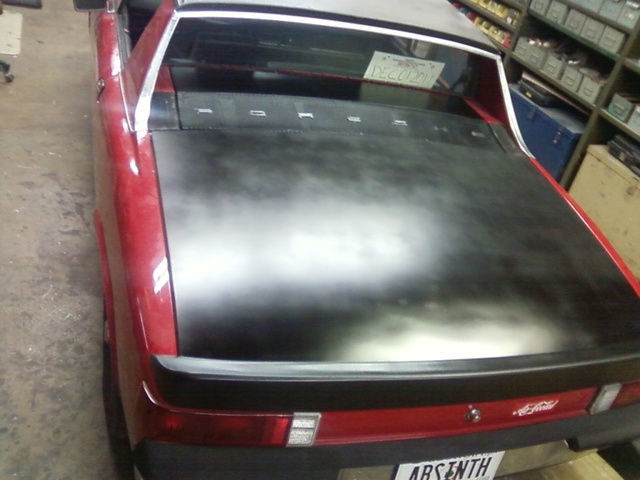

Trunk and engine lid attached.
(IMG:http://www.914world.com/bbs2/uploads_offsite/i921.photobucket.com-11654-1315408927.2.jpg)

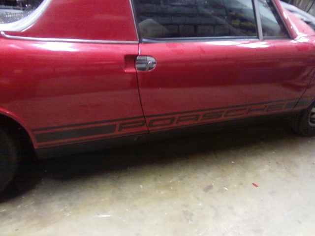

The incorrect side stripes.
(IMG:http://www.914world.com/bbs2/uploads_offsite/i921.photobucket.com-11654-1315408927.3.jpg)

QUOTE(ripper911 @ Sep 7 2011, 11:22 AM) *
Using that kind of rattle can paint you will need to put on alot more to get rid of that splotchy look .....
Its a matter of putting alot on, then sanding it smooth via wet sanding.
Rich
