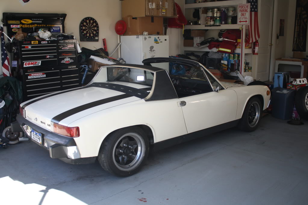

ripper911   I've started the painting process. Went and b...   Sep 2 2011, 05:07 PM

ripper911   :ttiwwp: Here is the reason for doing this, a la...   Sep 2 2011, 05:51 PM

ripper911   Here is the rear lid w/ spoiler. http://www.914wor...   Sep 3 2011, 05:45 PM
bigkensteele   I would put a few more coats on and let it cure fo...   Sep 3 2011, 05:55 PM
ripper911   Well, we set up a temporary paint area to keep the...   Sep 4 2011, 06:34 PM
ripper911   The repainted engine lid. http://www.914world.com/...   Sep 7 2011, 09:22 AM

'73-914kid   This took 2 cans of snadable primer, and [b]3 ca...   Sep 7 2011, 03:59 PM

ripper911   I used rustoleum black primer and krylon satin bla...   Sep 7 2011, 05:22 PM

ripper911   Here is the final product. :driving: http://www....   Sep 14 2011, 03:57 PM
'73-914kid   Looks good, I like it :beer2:   Sep 14 2011, 04:17 PM
rick 918-S   If the blotches really bother you wet sand lightly...   Sep 14 2011, 09:39 PM
ripper911   I had it all looking good a couple of times but ke...   Sep 15 2011, 04:46 AM
