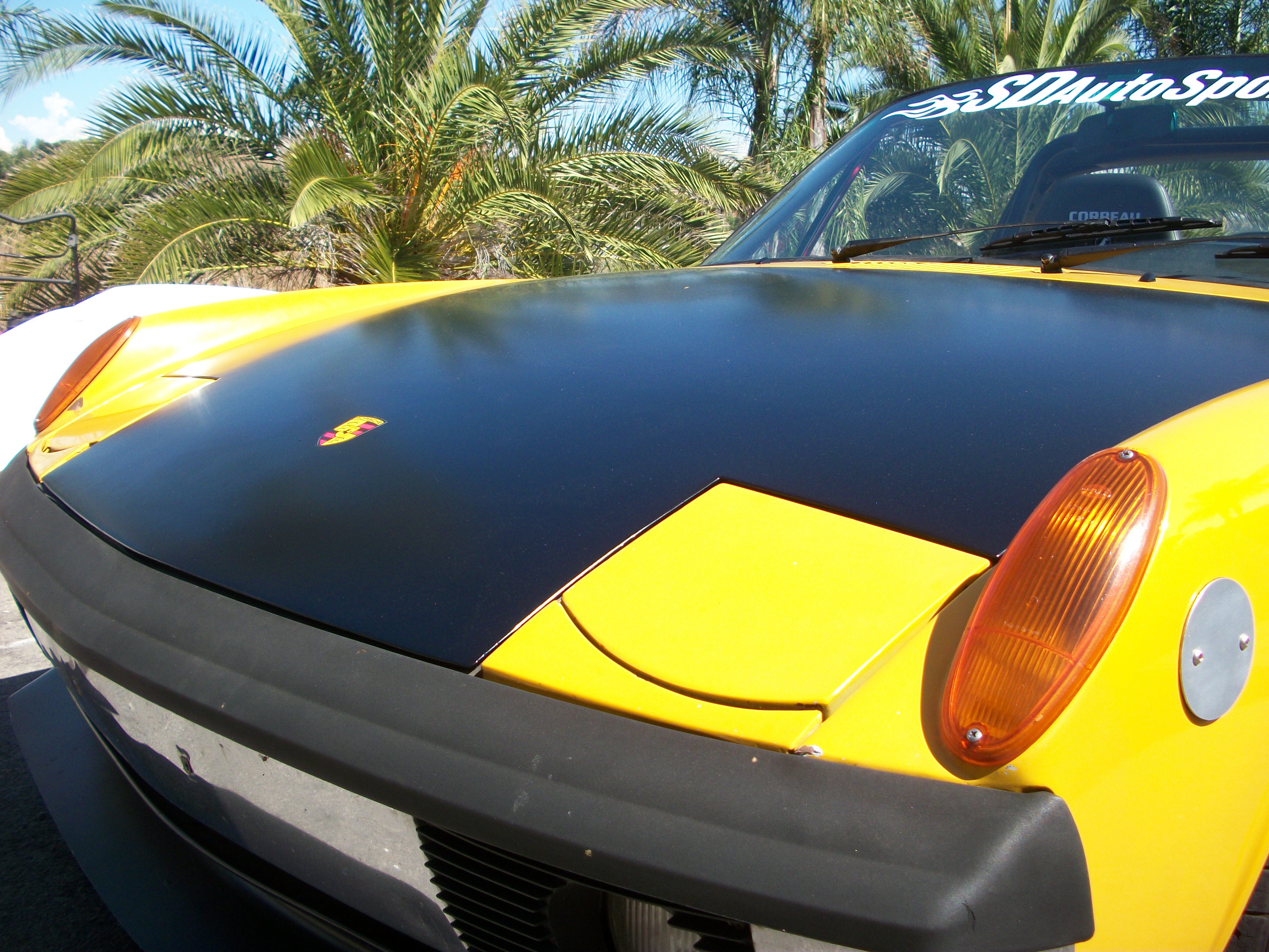

This took 2 cans of snadable primer, and 3 cans of Rustoleum Satin black. It came out almost perfect, and far surpassed my standards for rattle can.
Like it's been previously stated, it takes a LOT of paint to get rattle can to look even, especially satin. I did all my prep work on a saturday, then sprayed black on sunday. No wetsanding te black afterwards, this is just as it came out of the piss can. It can be done nice if you use enough paint... (IMG:style_emoticons/default/wacko.gif)
pcar916
post Sep 7 2011, 04:59 PM
Is that a Lola?
Posts: 1,524
Joined: 2-June 05
From: Little Rock, AR
Member No.: 4,188
QUOTE('73-914kid @ Sep 7 2011, 04:59 PM) *
Where did you get this Porsche sticker? I have two on my car and need a couple more for the repaint.

'73-914kid   This took 2 cans of snadable primer, and [b]3 ca...   Sep 7 2011, 03:59 PM
pcar916   Where did you get this Porsche sticker? I have...   Sep 7 2011, 04:59 PM

'73-914kid   I got the crest sticker from a local porsche parts...   Sep 7 2011, 06:03 PM
