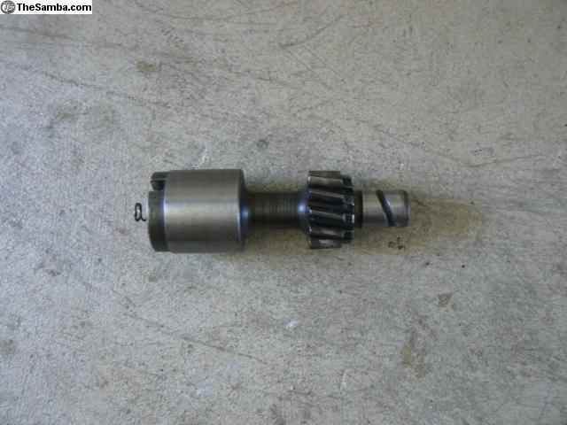

2.0 Djet. I changed out the plate due to a disconnected ground about a year ago and cleaned and lubed everything at that time. It has worked fine since then, til yesterday. Went to start the car and it did not sound right. Then no spark. Fiddled with a few things to make sure the wiring on the coil did not rattle loose etc, tried again and the distributer rotated 180 degrees and exposed this fancy new hole.
Attached Image (IMG:style_emoticons/default/ar15.gif)
Towed it home and dismantled the distributer this morning to find the following.
It had been wearing away for a while based on the metal shavings. The shavings are not brass / bronze from the normal wear of the rotor /cap.

Actually the bottom 1/4 of your drive is ok. That just how they look. Cant remember why though, i think it was clearance for the case or thrust washer or something.
