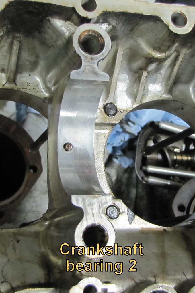

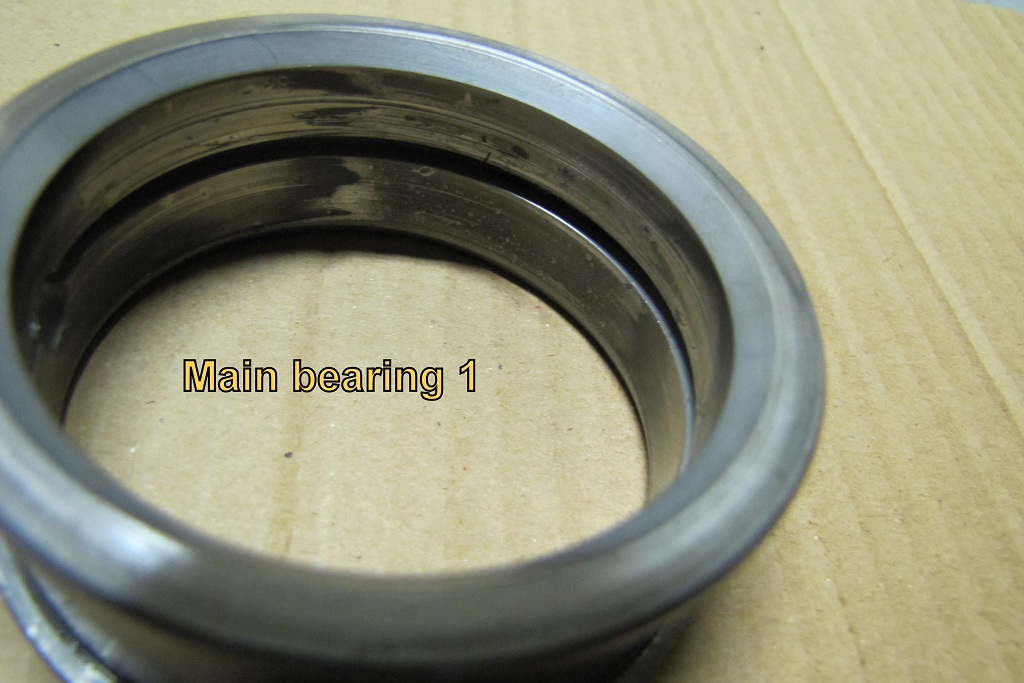

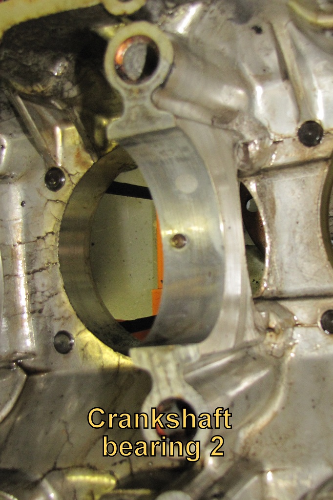

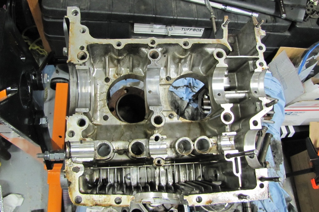

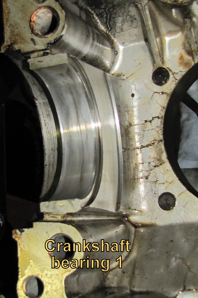

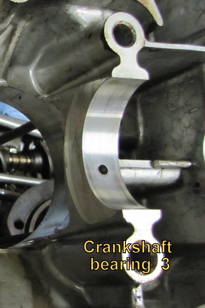

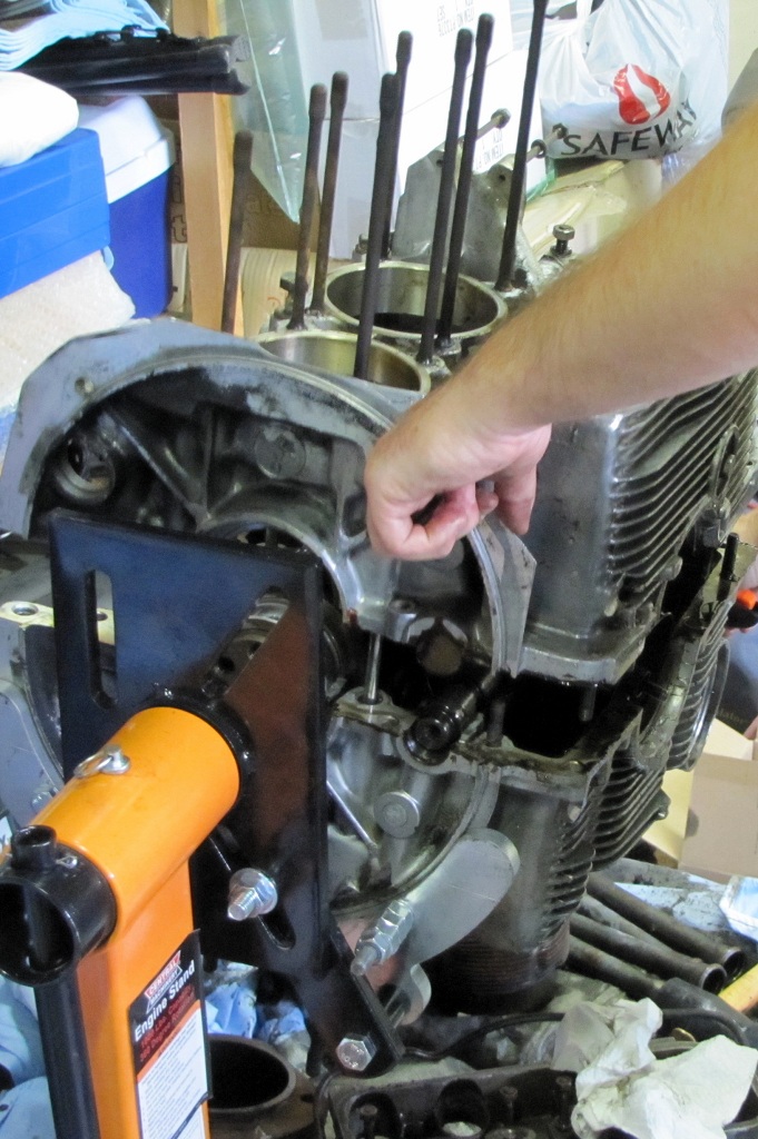

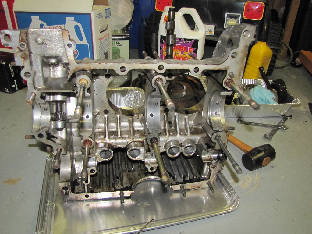

Finally I split the case. The bolt behind the flywheel was the one I missed. Thanks for the help so far.

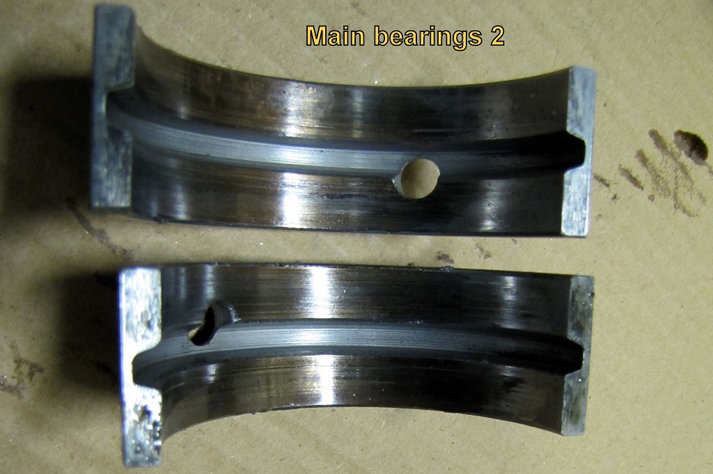

The bearing pictures are not so pretty.
Main bearing are done. Standard size bearings. After seeing the ones that come out easily, I didn't bother with the last one on the crank.

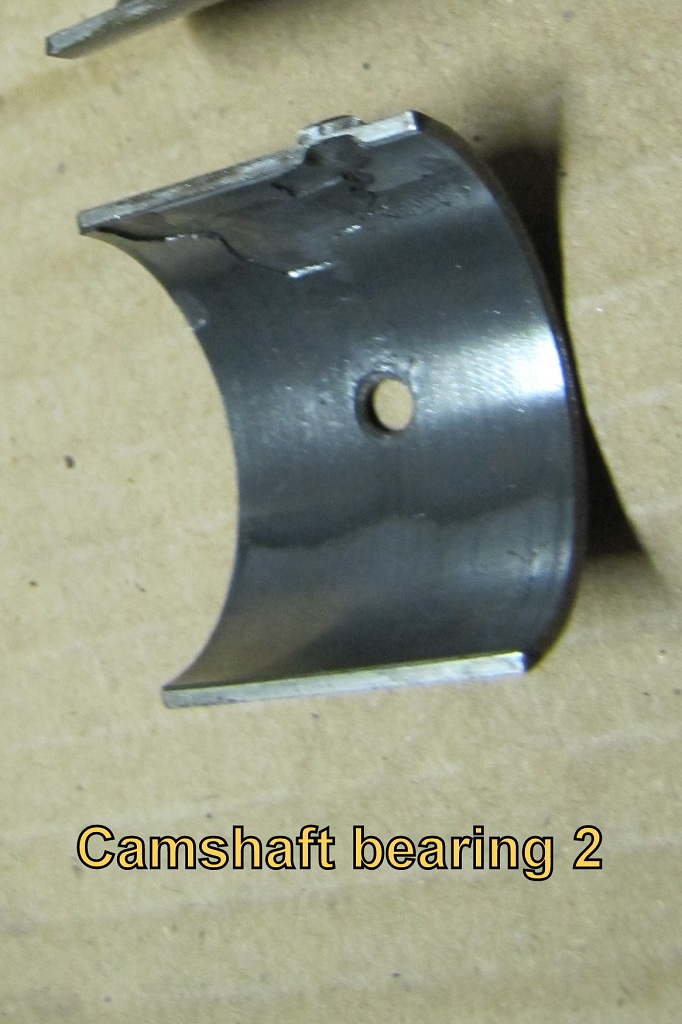

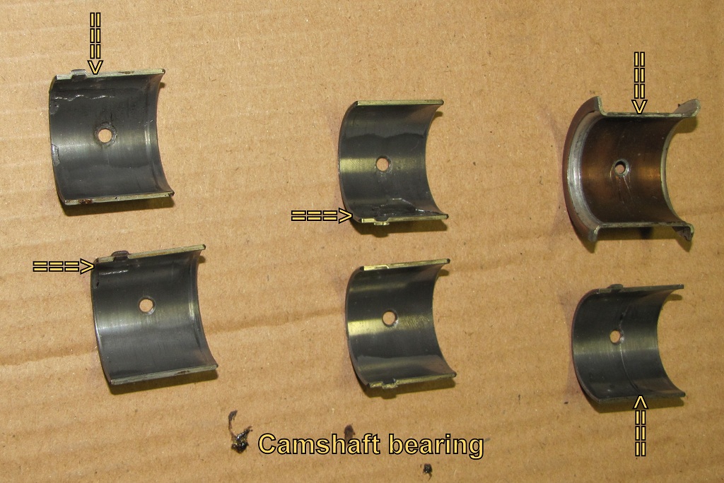

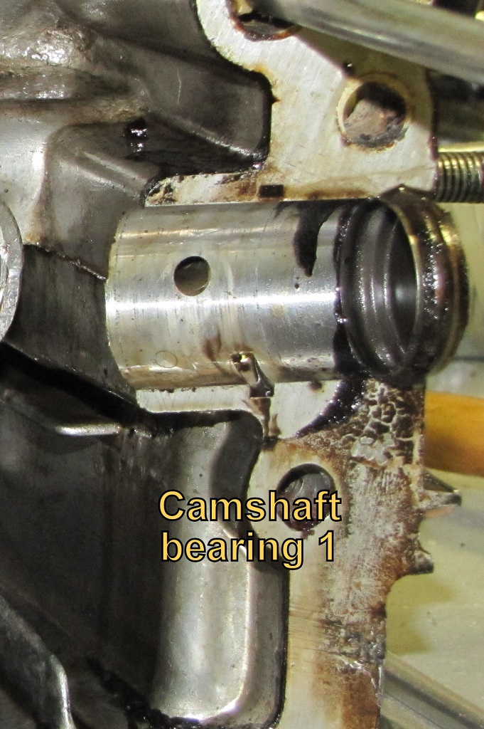

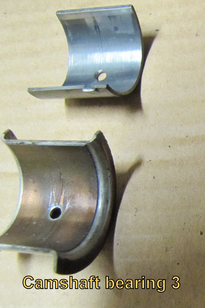

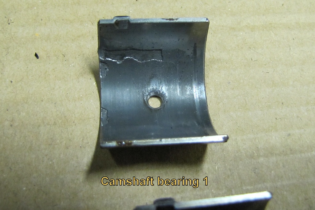

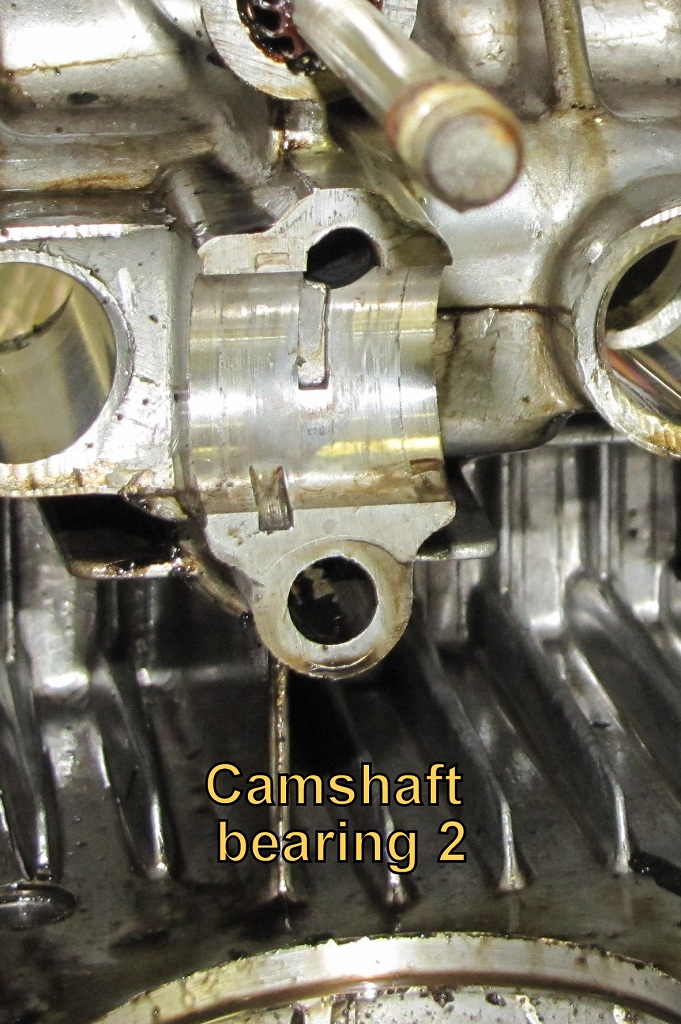

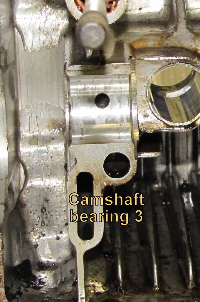

The camshaft bearings were German SK and are all junk now. 1 and 2 broke and 3 has much more wear on one side (the bigger half lost its coating and you can see the copper while the other side has still the coating on it.

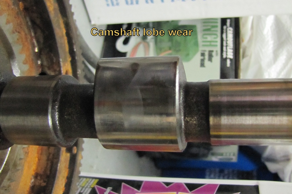

Camshaft shows some wear as well. I'll probably need to replace it.
This engine was identified by the Cap'n as one rebuilt by Volkswagen Canada that, as he said, are of questionable quality. Well, the Cap'n was right, no questions here anymore.

Valy   Put all my flat screwdrivers away so I won't b...   Sep 9 2011, 12:30 PM
stugray   Chances are you missed a bolt or two. The case re...   Sep 9 2011, 01:20 PM
Valy   Chances are you missed a bolt or two. The case r...   Sep 9 2011, 01:44 PM
bigkensteele   Chances are you missed a bolt or two. The case ...   Sep 9 2011, 02:01 PM
Valy   Where did you get that cool billet engine stand a...   Sep 9 2011, 06:21 PM
Matt Meyer   Splitting Case Halves Classic Thread shows bolt lo...   Sep 9 2011, 01:48 PM
