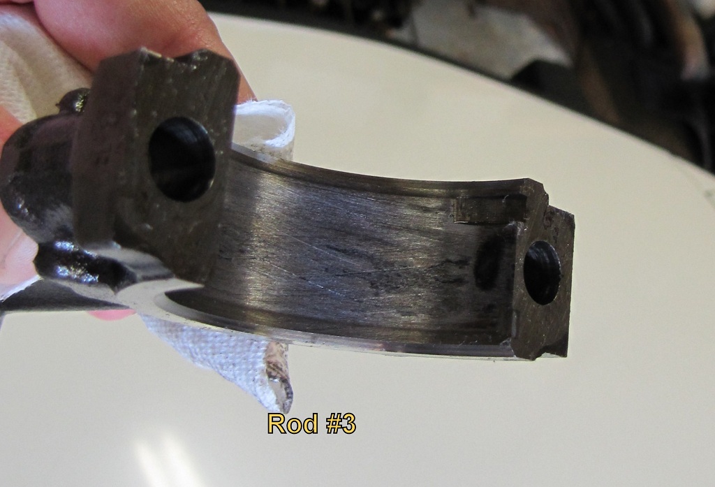

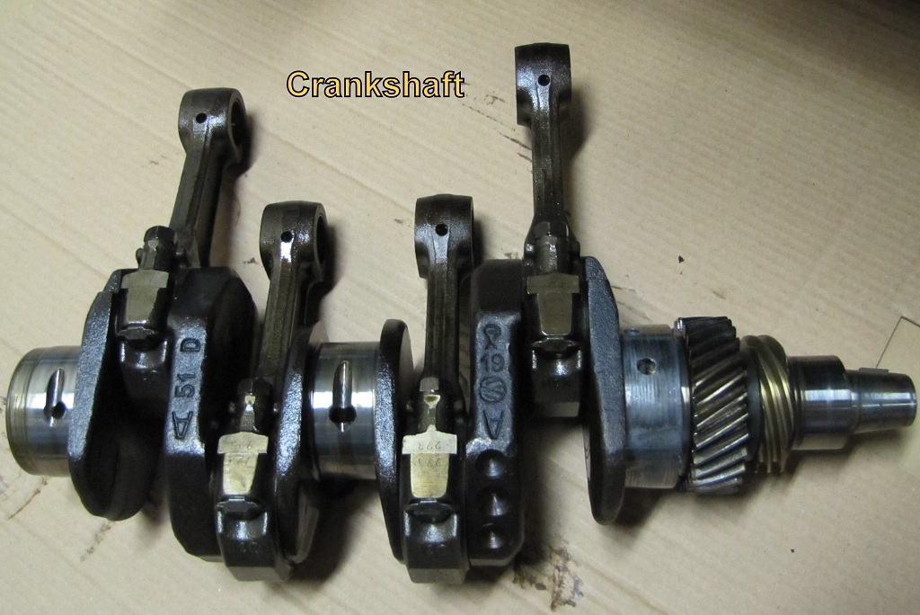

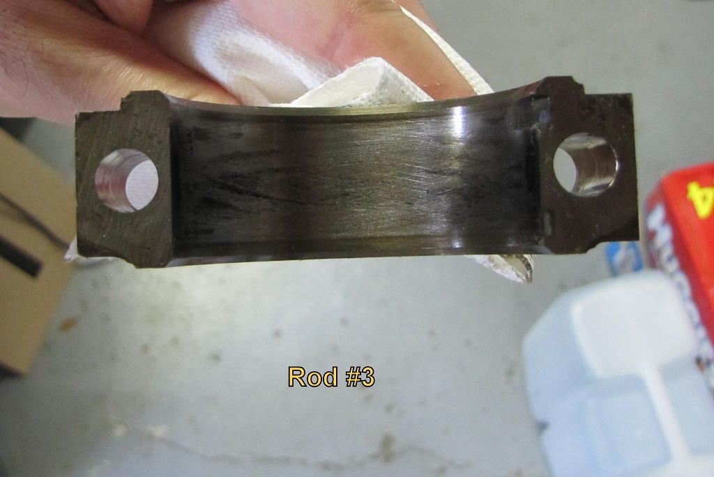

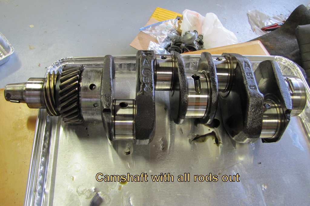

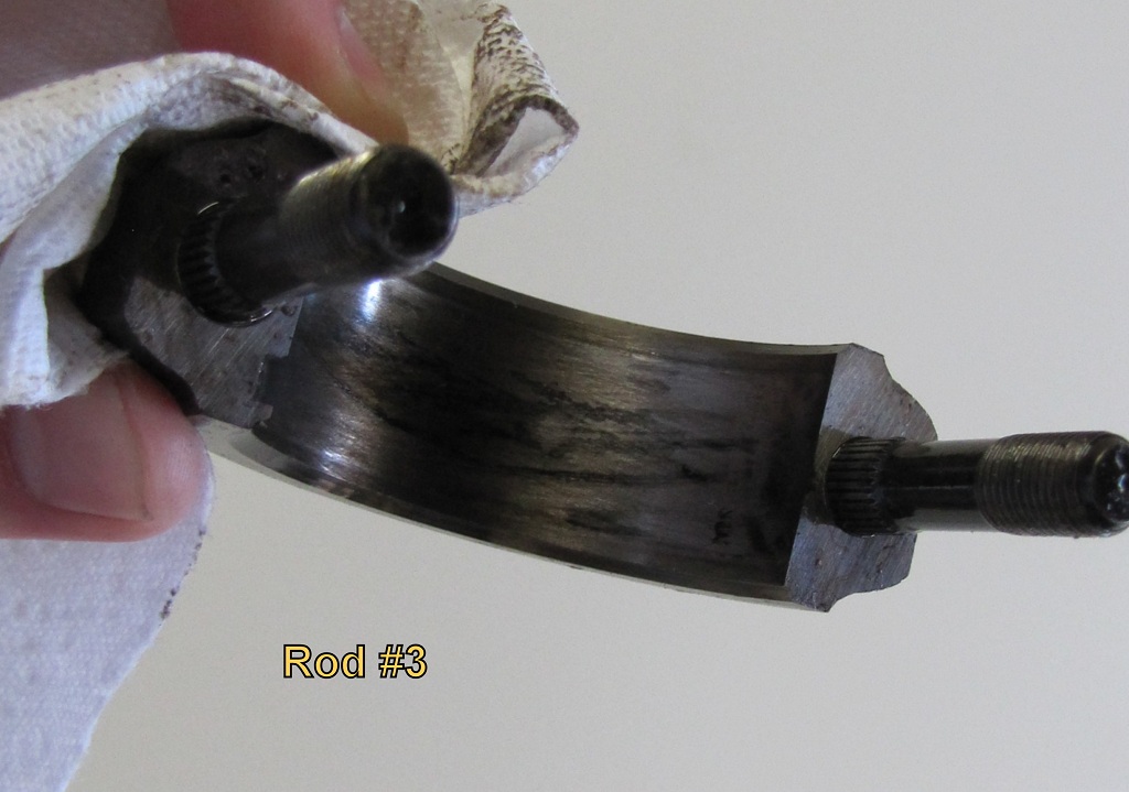

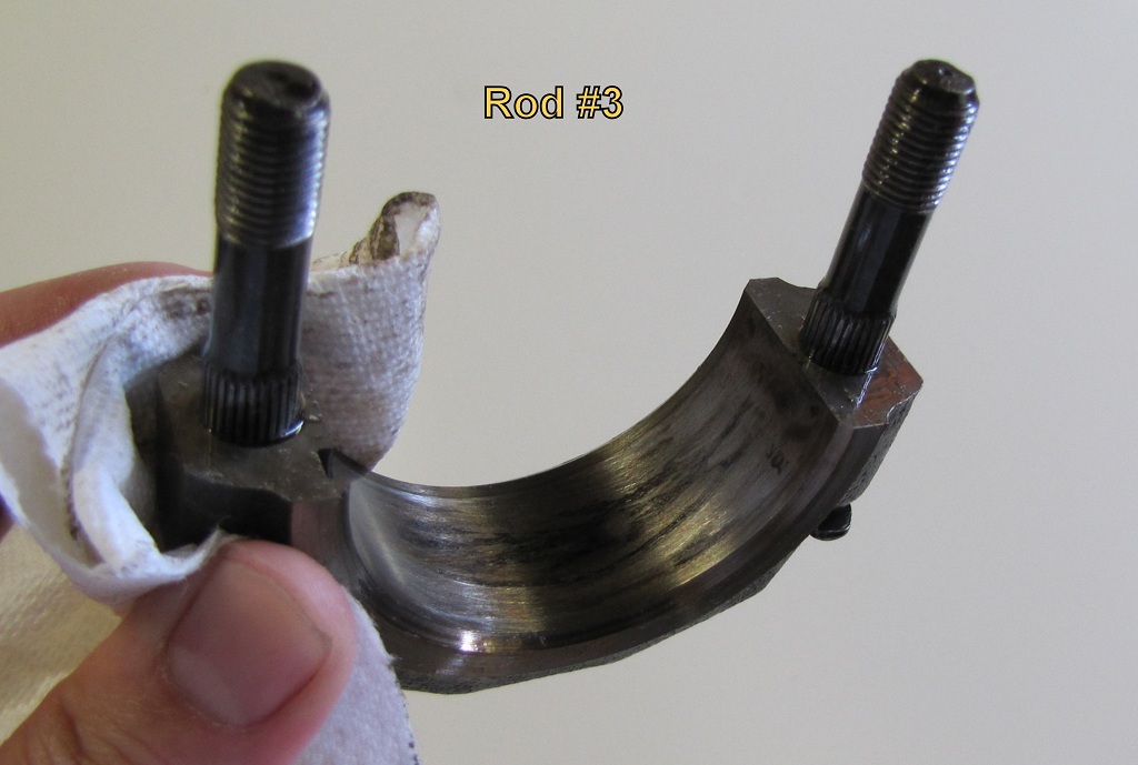

Crankshaft and Rod journals.
Some pictures of the crankshaft and the rod journals.
The crankshaft looks fine but the rod journals are not so nice. I'm not sure how those marks got there. The rod bearings are toast.

Vacca Rabite   Looks like an engine that had a lot of miles on it...   Sep 11 2011, 07:23 AM

SLITS   The marks in the big end of the rod are from machi...   Oct 14 2011, 01:46 PM
